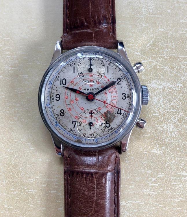

Photo attached. Just curious whats the best way to clean up this dial???280a2607b64c3641516b67ca7d8c662a.jpg
Sent from my SM-G950U using Tapatalk
That dial is perfectly aged.  Anything you do to it is likely to make it worse :mad:
Roger that.
