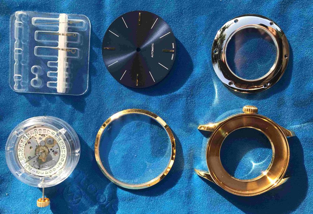

  8. Here we go, i have this Week my Project #3 completed, a Watch based on a 2824-2/ST2130 Movement. As i am a Beginner, this is an example for a successful Assembly. The Case, Dial and Hands are from the same Seller, the Band is from Hirsch, but the Buckle is from China, the Movement is a Seagull ST2130. Lets have a Look... i hope you like it it regards, Ernst
