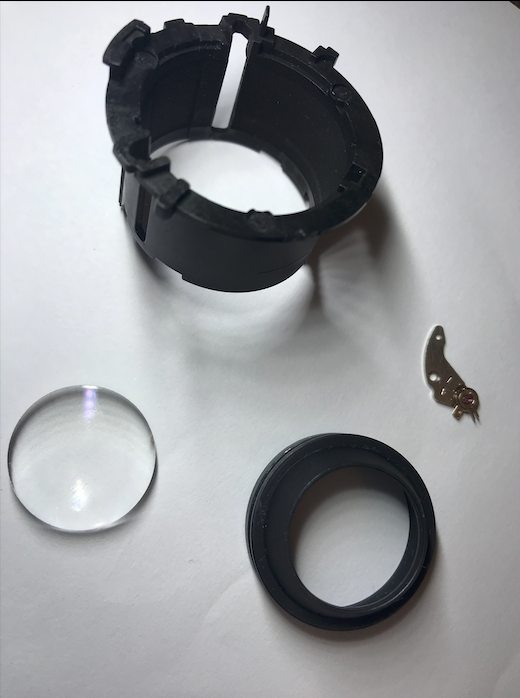

  1. Made an Watch Makers Eye loupe using a old Camera lens and it plastic casing. Without spending a Penny.
    2 points
