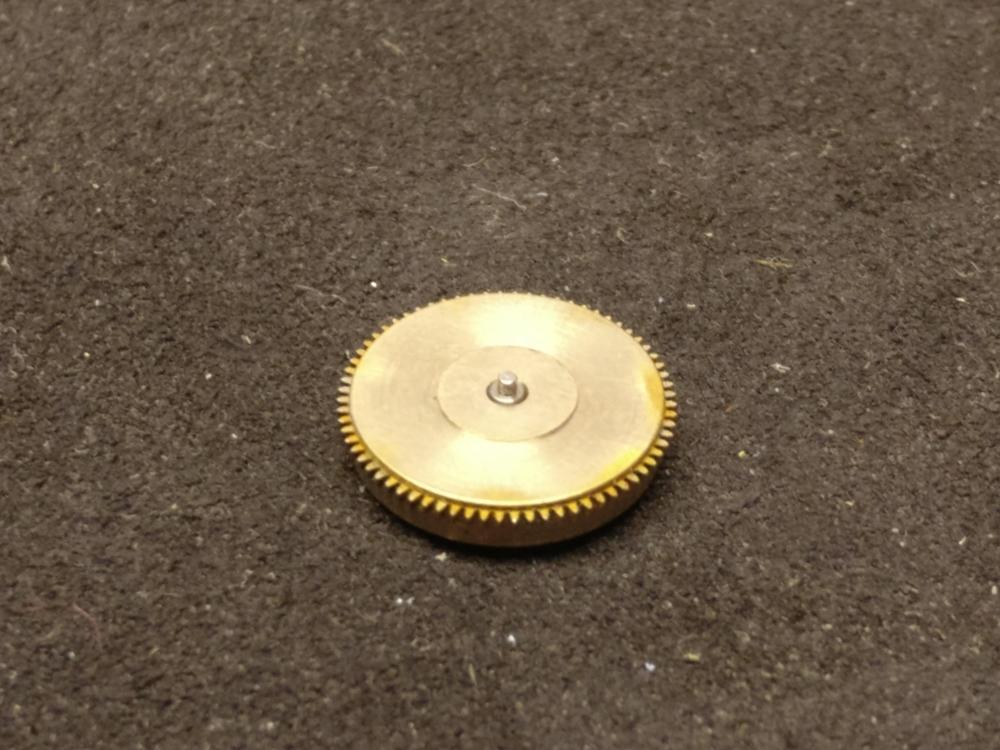

Push on the arbor pivot to dismount the barrel plate (the arbor pivot on the gear side of the barrel, side that's got gears) show on top, facing up in image you provided.
The barrel plate is on the othe side( facing down as show in image).
Use the flat part of your tweezers ( the end not the tip of tweezers) or a coin, to push on the arbor pivot, till the barrel plate cracks open.
Get the arbor pivot out of the plate ( don,t grab and pull the plate ). Once the mainspring and the arbor is revealed, hold the spring with one finger inside the barrel to remove the arbor from the spring.then starting from center pull the spring out, let unwind out ,not just grab and pull out Th spring unwinds violently, use a protective pair of glass or gogles. You should try to control the spring coming out. Don,t just pull out rather let unwind small length of it outside the barrel while the rest of the spring still remain in barrel. Any method you deem for safety.
 Take a picure of the spring before taking it out of the barrel, this helps with reinstallation.
