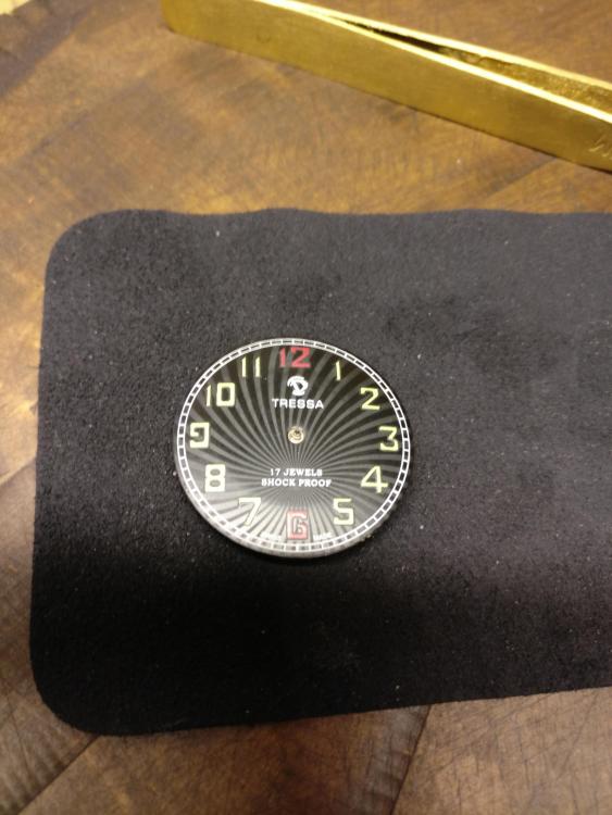

I am looking for some help on how to remove the watch dial from the movement on my ST96 from the mid 70s. I have got the movement out of the case and the hands removed but I am stuck on how to get the dial off.

There are small screws on the sides of the movement that press against two ‘feet’ that go into holes in the movement. Loosen the screws and wiggle the dial off.

Gpsluvr and Nucejoe thanks for the information. I think I located the holes each of you were referring too, but I don't see any screw to loosen. I attached some additional pictures. I used my magnifying glasses to look in the hole and I can't see a screw.... additionally I don't have a screwdriver small enough to fit in the hole. I could file one of my down to fit in the hole but I just can't see a screw to loosen.

Two possibilities.
1. Dial plate has one or both feet undamaged.
In which case the dial plate is hanging there loosely.You can check between the dial and main plate, you may see the feet or insert in a razor blade between dial and main plate , the feet, if intact, will stop the blade at a point, three mm. If both feet are there ,just wiggle out the dial.
2. The dial feet are broken.In which case, The dial is glued on at previous repair. Just cut through the glue with a razor blade to cut the dial loose.In such  case the residual glue is a mess and can only be cleaned off with the main plate submergerd in solvent.
One feet intact the other glued is just as a mess.
Avoid forcibly wiggling the dial out, bends and gets damaged easy.
Dosn,t look glued, if the plate slides sideways or at all, it is free( not blued on) .free to be wiggled out.
Chances of screws broken and tip of screws remaining  in the holes to keep the dial firmly are very slim.
Looks like all you got to do is wiggle the plate out ,EVENLY and easy.

Is there another screw hole around the other side? Is there not a screw in it either? Take a few pics around the edge of the movement, that may not be the dial screw hole.

One feet may be intact and screwed down, the other feet broken.
The other whole is almost 170 degrees around the other side.
Give it a go leelemon, this movement is easy to work on, I have got all the parts you may need and will stay with you till last drop of blood.:Bravo:. Just save the dial, you will have a good runing watch.
Thanks Nucejoe , watchabit between each of your advice the dial is now off of the movement. Turns our feet are intact, no scews and it was glued.... ugh what mess. Recommendations on solvent to remove the glue but not damage the dial face?
