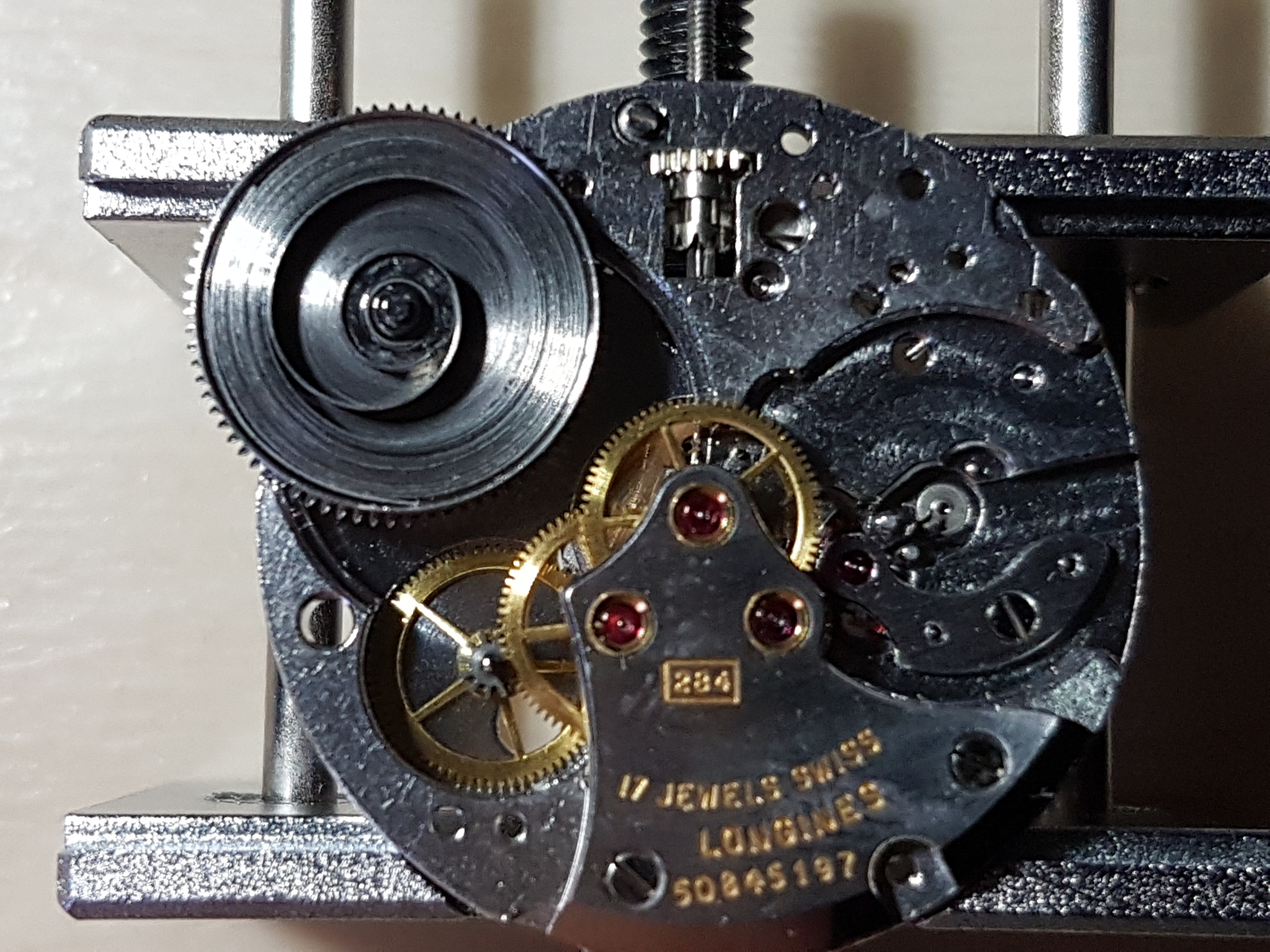

Longines cal. 280
I'm going for an AS movement - the general layout, screw/jewel positions are similar.
I haven't yet but I will take it out tonight! Thank you. Will post pics of dial side tonight too.
Did you have a look under the ballance? Often the movement maker/number is hidden there.
