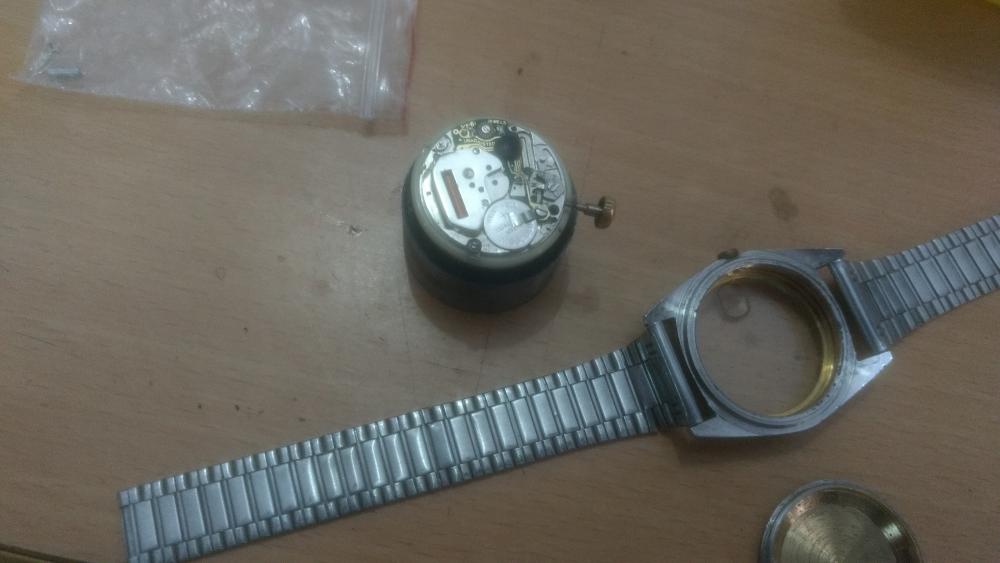

Hi all, this is my first post here. I repair watches as a hobby, and usually work on my own watches. This particular watch, along with two others, were give to a friend of mine, by his father, about three days before he passed away recently. The three watches, hence have an emotional value to my friend, and so, I wanted to get them going again. I fixed the QMax (Replaced battery), Titan (PCB and Coil, new battery, glass), and am working on this Rolex now. Almost all Indicators of a genuine Rolex that I have read of online, are absent, hence making me believe its most definitely a fake. i.e. No serial number or any stamping anywhere on case, no Logo on crown, Dial looks as if its been lacquered, bad finish, bracelet, and most importantly, no markings on the movement, and the movement was not used on any Rolex to my knowledge. Please enlighten me on this, if I am wrong.
The issue I have now, is that, on the movement, there were no markings whatsoever, of the make or model. There were only serial numbers that read as "34B - 963125". After searching a lot, I realized, its an ETA 963.125, and photos on the internet matched with the movement I have. No marking of ETA on the movement (a fake again?). Its in a pretty rough shape, with the quartz oscillator (forgive my lack of knowledge of its correct name, as mechanics call it a "condenser" here), fallen apart. I did a preliminary  search with the mechanics and spares shop here, and they all said its very old and parts are not available. Only one said, he will get me a scrap movement, but I am a bit doubtful. I was able to get a service manual for ETA 963.124 online. My question now is, is it possible to get these spares, or the whole movement anywhere in Bangalore, India? (my place), or is it possible to replace the whole movement with a different one, with the day and date windows matching with the dial? Or is it possible to reuse the same day and date rings on a different movement? Can anyone advice me on this? TIA. Pictures attached, forgive the lower quality, problem with my mobile cam.
There will be an equivalent movement for sure you might have to take measurements or a internet search. Whether it is worth doing is up to you, personally I would not bother as it is not even a good copy of the genuine.

Can try an ISA 1198. Or alternatively could fit an ETA automatic, but check overall thickness and most importantly “stem height”.

It’s a fake watch, so no movement is technically correct. However, for early ETA quartz, sometimes the closest available equivalent is a mechanical. For example, ETA 536: ETA 2836.

Thank you. As i did mention, its not the monetary issue here, but its more of a memory to my friend of his father.
Thank you sir. I guess I'll keep it quartz as much as possible.
