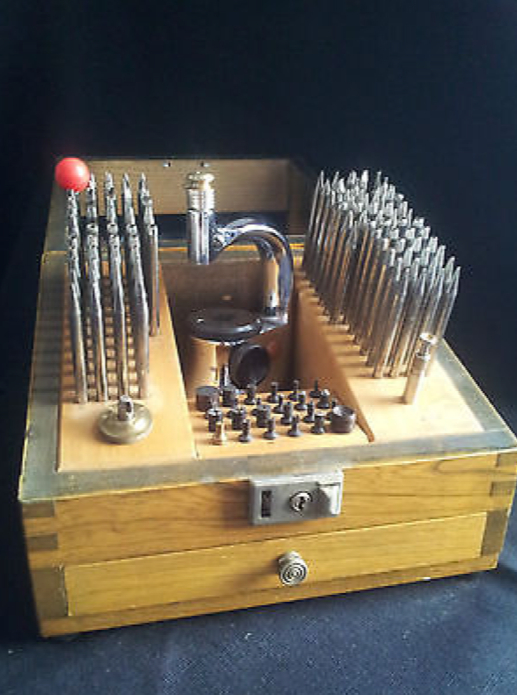

Just bought this M.K.S almost complete with 110 pieces and little used. Only need to replace 3 balance staffs against replacing the complete balance and it's earnt it's keep.
Just hope it will do the job.
