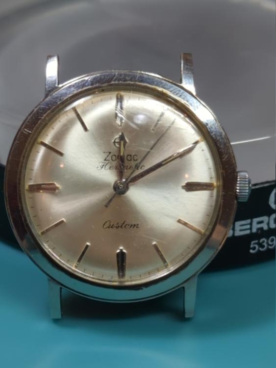

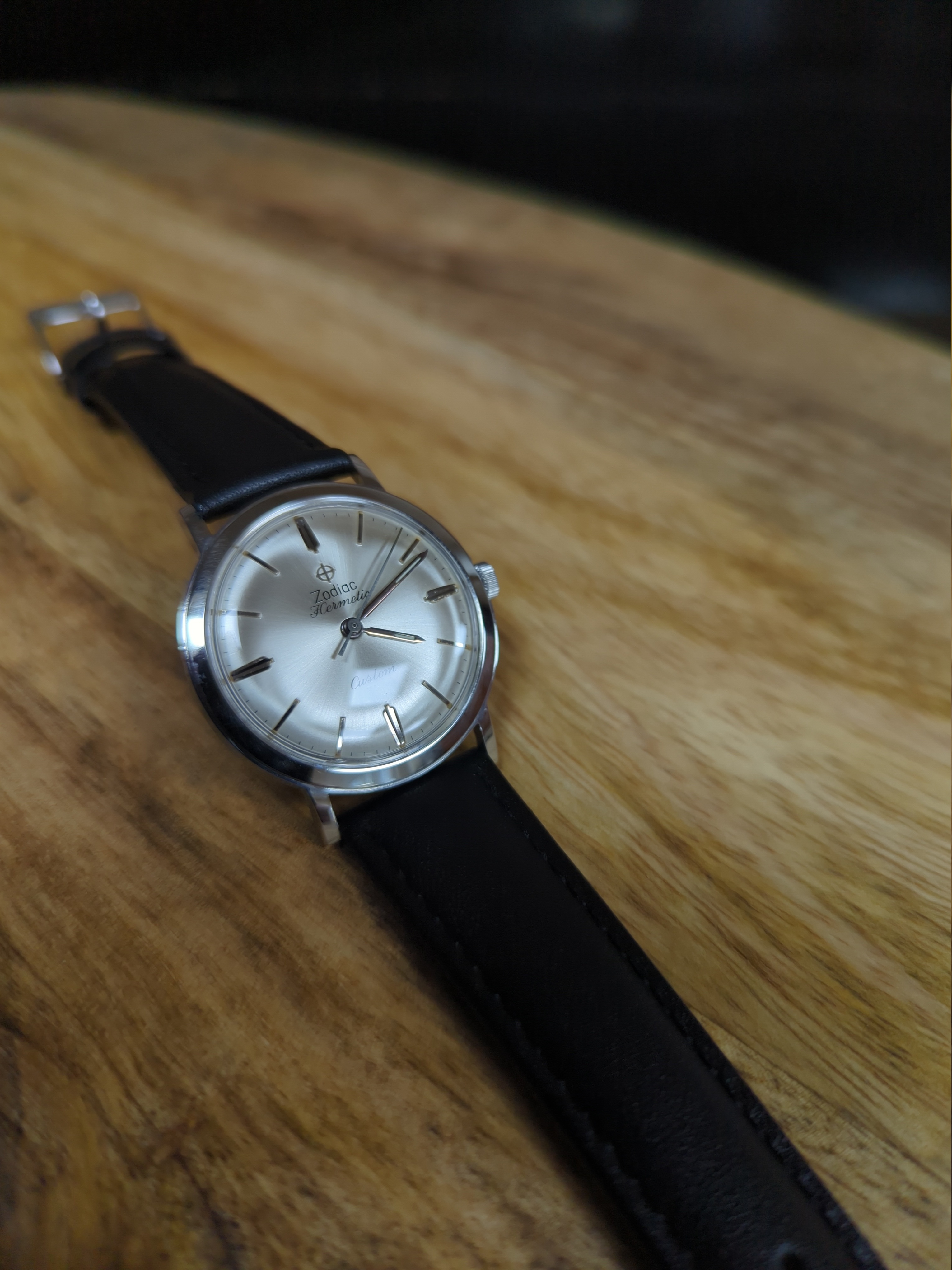

Good day everyone, I just completed a watch for my wife's uncle as a gift, its a Seiko 6309 which was in pretty poor condition and a non runner for obvious reasons. I had to replace the crystal and the ratchet wheel which was completely corroded (see pictures below) I also had to replace a screw and the cannon pinion. A quick lume on the hands and polish the case and it was good to go. Let me know what you think:
Before Front:
Before Movement:
Corrosion damage to ratchet wheel and screw(s)
Here is the finished watch along with the time graph after 24 hours:

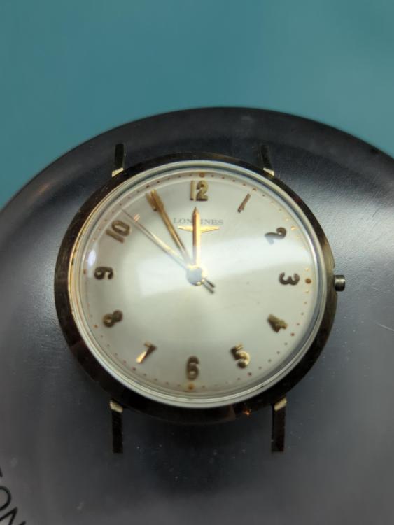

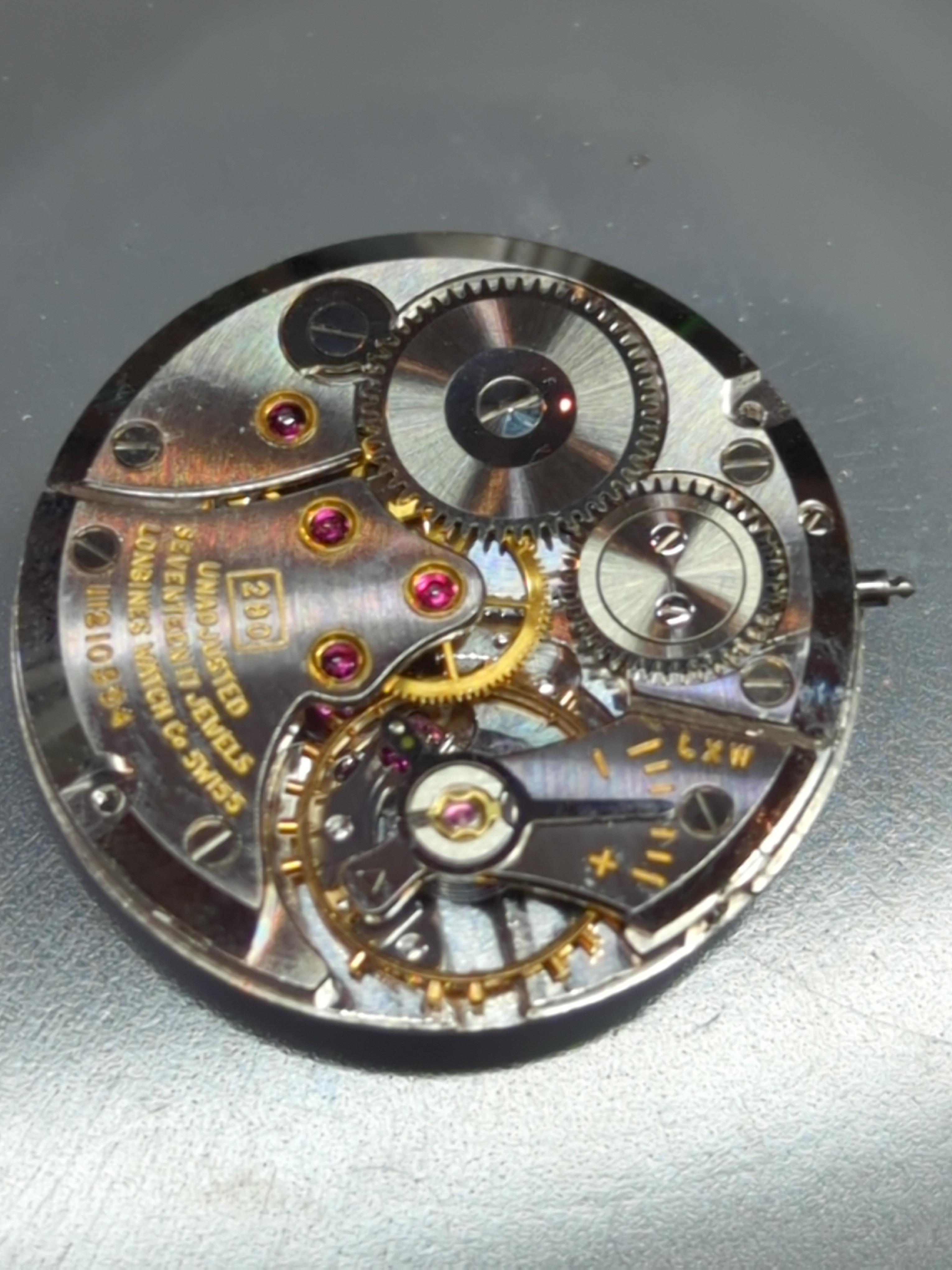

This is a Longines Cal 280 which I started a while ago which was a non-runner and turned into a bit of a marathon when I ran into issues with the mainspring, I took the barrel and mainspring apart to clean as normal, but couldn't get it back together, which is when I realised that unlike many watches the sealed unit warning on the barrel rely means sealed unit. After a false start with a bad spare part choice I ended up having to get a whole new movement.... but as it turns out this was a good (lucky) call as I also needed to replace the escape wheel (broken pivot) and to replace the cannon pinion. Dial was in great shape and the hands just needed the lume replacing. Before and after shots below 🙂
Before Front:
Before movement:
Finished watch:
