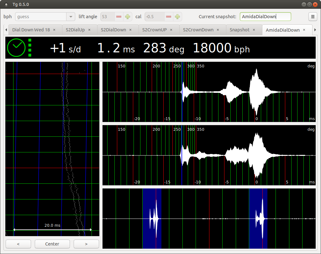

A little more tinkering and I have over 270 dial down and over 250 dial up for the Amida.
There is no easy way to adjust the beat error, so I think I'll declare this fixed. :D I wouldn't want to push my luck too far.
I'm happy with those numbers.

I find that a 'large' cheap ebay etc oiler and a balance tack enable beat error adjustment via the collet relatively easily, the BE on the Trafalgar jump hour was vast, 5.odd ish and I couldn't cope with that, when not easily adjustable i'll put up with up to 2.0 but dislike anything higher.
