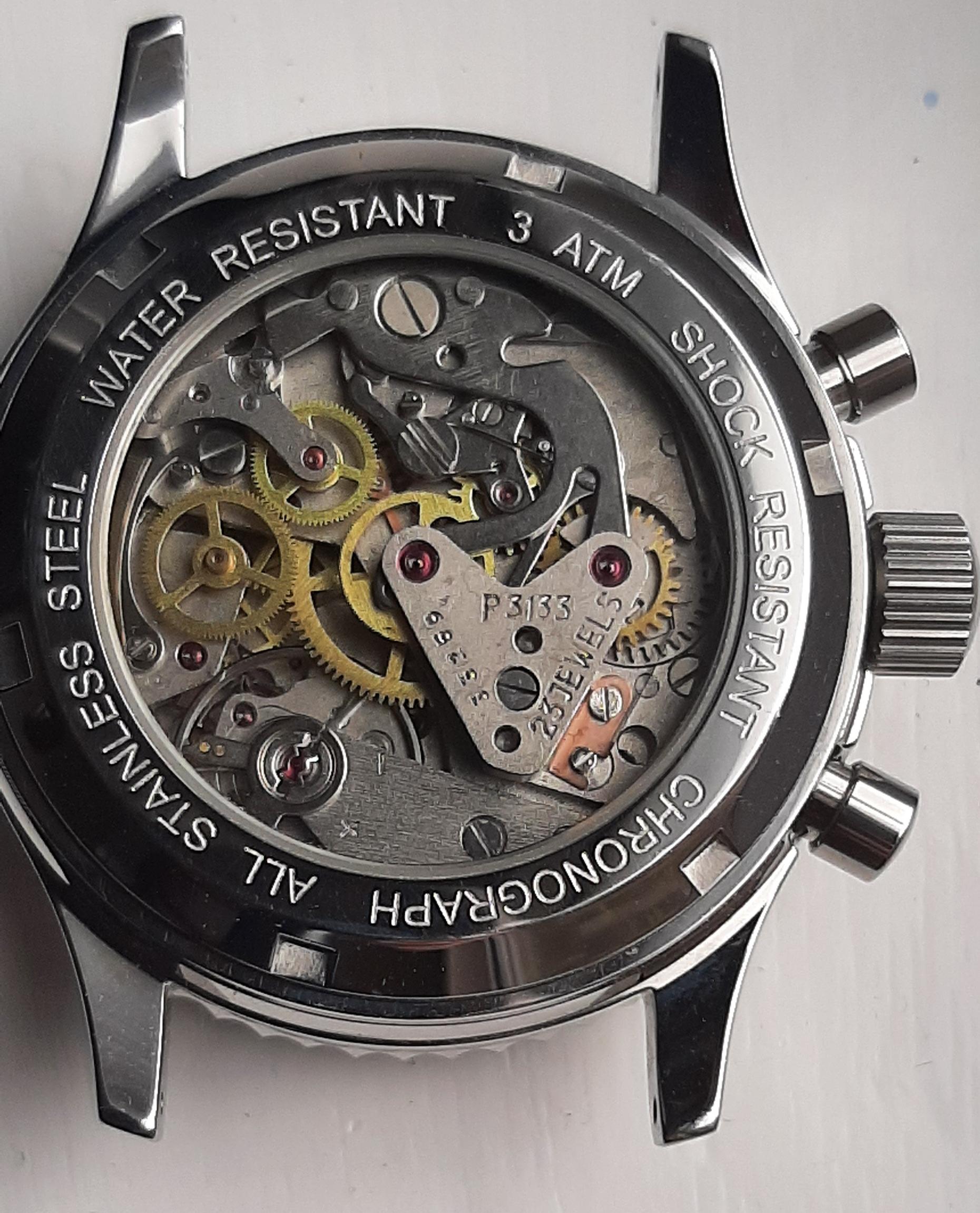

I bought from an ex. Poljot salesman, this undisturbed Shturmanskie "classic" with a Poljot 31659 movement. The Poljot 31659 movement is almost identical to the Poljot 3133 movement, but it has an additional balance-hack. The watch has never been used, never been worn, just sitting in a drawer waiting to see, after all those years, daylight again. Before it gets wrist-time, a service was overdue.
The "pop-off" the back-lid was anything but "pop-off". The provided slot was of not much use and I ended up driving carefully a scalpel-knife in between the lid and the housing seam; slowly creating a gap big enough to insert a blunt knife. Even then, it took a huge force to get the lid to "pop-off". Needless to say, the nice, nearly virgin lid has now its first unavoidable marks. The light surface scratches on the lid are very minor, but appear more severe on the picture due to the light reflection. The Plexiglass crystal is scratch free, but has some minor aging-cracks.
The inside reveals an undisturbed 31659 movement, with 2-88 stamped in the chronograph bridge. February 1988, that's to date exactly 29 years.

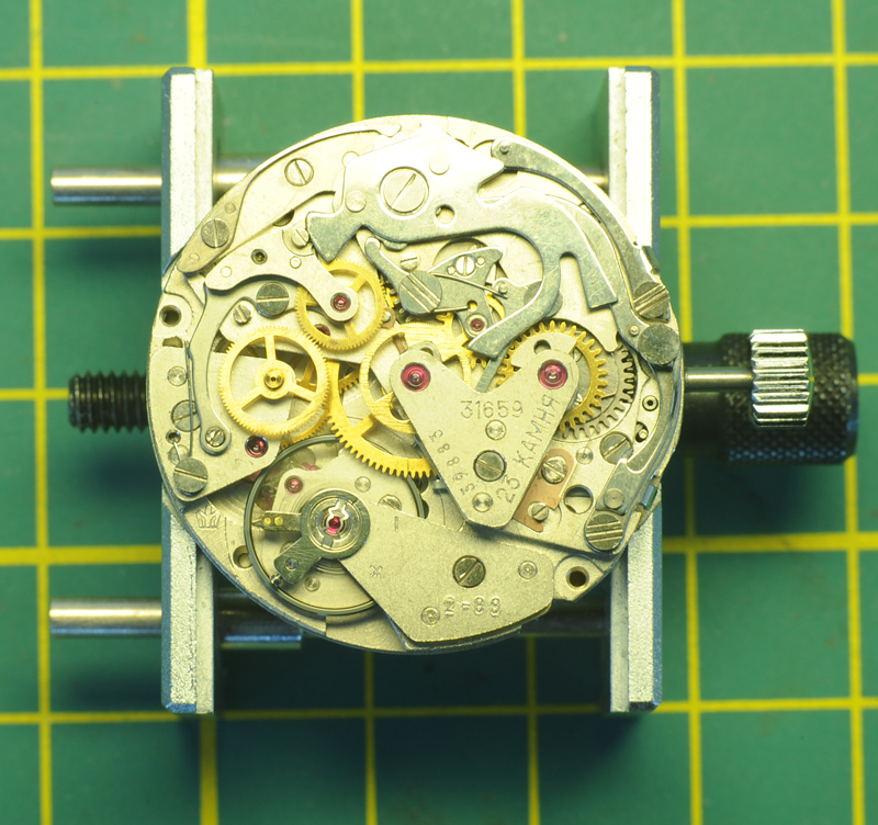

I took the movement out, removed the hands and dial. This time the small seconds- and minute recording-hands came off unharmed. However I wasn't that lucky with the big chronograph seconds recording hand. It was so tight, that even with great care, in the end the hand stripped off its pipe-bushing :( With the hands and dial out of the way, I managed to get the pipe bushing of the pinion without any further damage.
As you can see on the picture, The outer ring has one screw missing, so has the calendar center plate ....... I guess the factory worker in 1988 didn't feel like it that day!? Can we still find out ? :biggrin:
Stripped the calendar works;
Stripped the keyless works, flipped movement over and removed balance assembly and pallet fork. One can just see the hack appearing from underneath the barrel bridge; see arrow;
Time to disassemble the chronograph components. Even though for a 31659 one has to deviate from the guide slightly during assembly, I can highly recommend this service guide made by WUS member SLLS on June 2015. Click on the link below to download.  Thank you very much SLLS for you excellent and clear servicing guide :thumbsu:

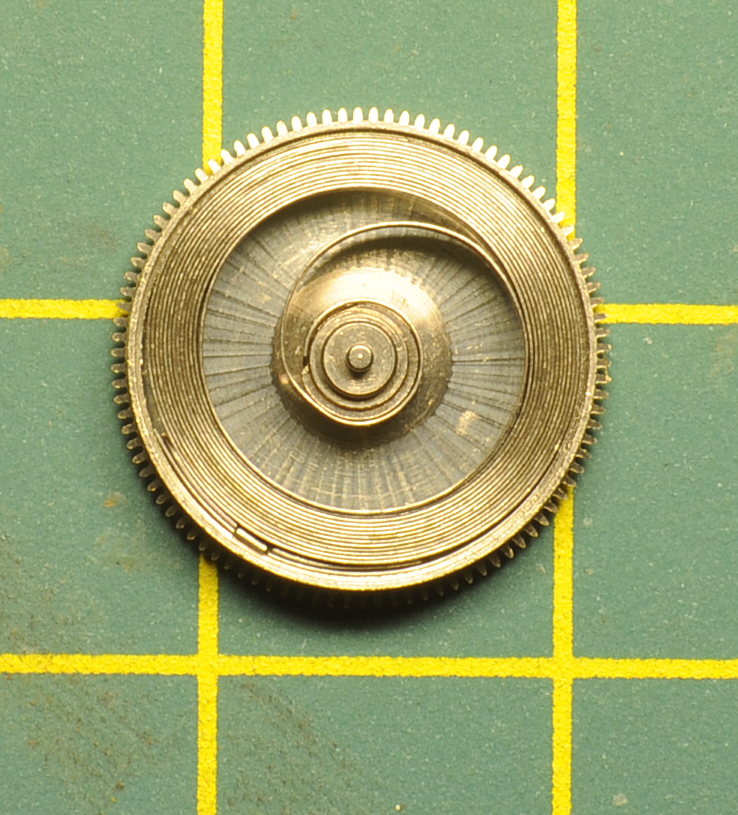

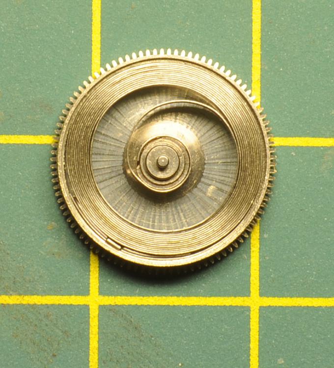

The main-spring seemed in a good shape;
Time to clean all the parts and lubricate the balance cap-stone in the main-plate. I use Rodeco as a support. Once to small droplet of oil is on the cap-stone, I turn the Rodeco top-down and insert the cap-stone in the chaton. Works very well for me ;)

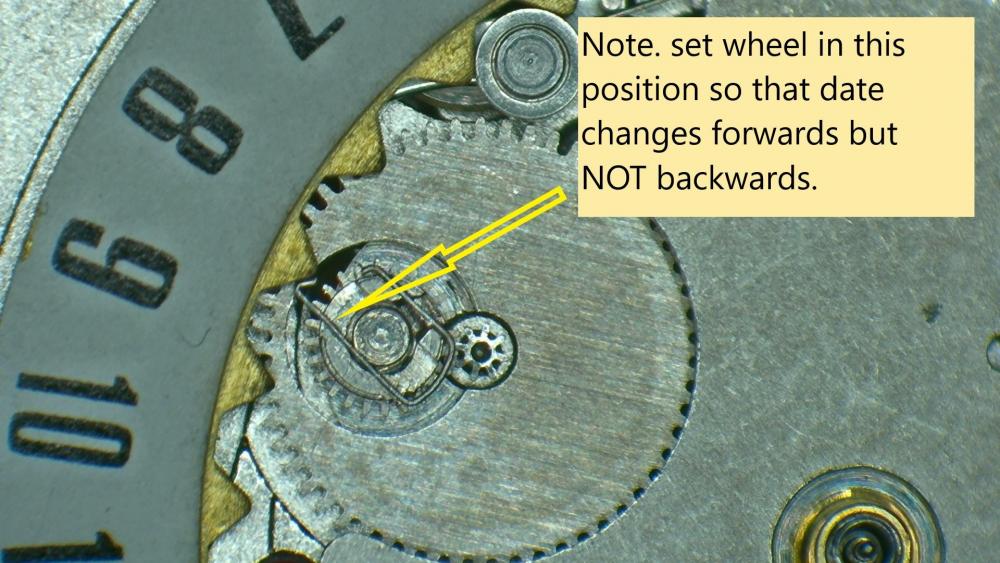

I just finished putting my watch back together, but the quick date setting technique would not work - change from 12-11-12 should advance the date. Once mine had advanced the date, turning the time back to 11 would turn the date back also. What I discovered is that the date setting wheel has to be in a particular position to work properly. The tab on the wheel needs to start pushing slightly past the centre of the wheel, as in the pic -
I just turned the small wheel one tooth on the fixed central pinion, and it worked
Edited by mikepilk
@mikepilk; you are correct 🙂
That's the way to set the "date setting wheel" correctly.
However, I've seen too many broken springs of the date setting wheel due to the fact that the 12-11-12 method was used. I do know that the official Poljot instructions do say that's a quick way to advance the date, but at the time when those instructions were written the world was awash with 3133 spare date setting wheels.
Times have changed.
The world isn't awash anymore with these setting wheels and I do strongly recommend not to use the 12-11-12 method any longer. The little spring gets supported, and therefor sees less stress, when advancing the date turning the hands clockwise. In the 12-11-12 method the little spring sees a lot of additional bending forces / stress (read additional fatigue) and will break prematurely. The only way to repair is to pull all the hands & the dial. I'm of the opinion that the date mechanism is one of the 3133's weak-points.
Best is to wait for the correct date (I'm sure that most of us do have more watches while waiting for the correct date) or advance forwards a few days.
