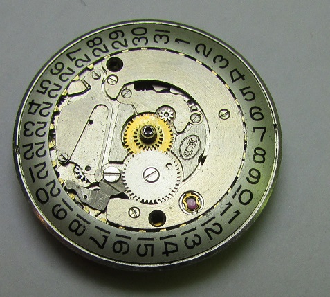

ebay purchase movement, which is OK, except the second hand post was missing. Probably why sold as spares or repair. Also have found one of the dial screws is missing
Fortunately tracked the movement down on www.ranftt.de and then on www.oldswisswatches.com, and tracked the movement down as an AS1674 and luckily found the part on ebay (the part cost more than the movement!!)

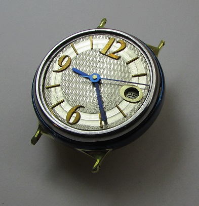

Hands completed and date viewer / hour markers made. Also did a layout to start seeing things coming together589762b63b1f5_No210.jpg.30edba5bc8b5baa0f733e2361252362d.jpg589762bb8b76c_No211.jpg.7167a5b314e54bb951713927c797863c.jpg589762be09608_No214.jpg.c848a6da19ac65d1340500c367f92339.jpg589762b7f2471_no215.jpg.45f5aabd09214d4bae58d0c8227b81e4.jpg589762b9ec68a_No216.jpg.21a32d01bcb6644b008b5986052fb8df.jpg589762b2c9325_No218.jpg.6cb7bd7104a05453069f64066bc87915.jpgsmall2.jpg.3aa4a82691aadf60bb9d85a70527273f.jpg

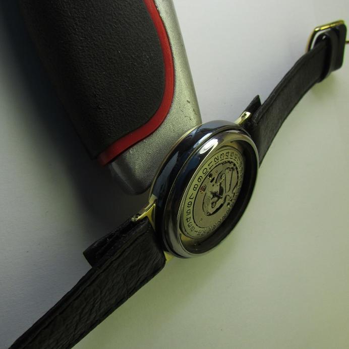

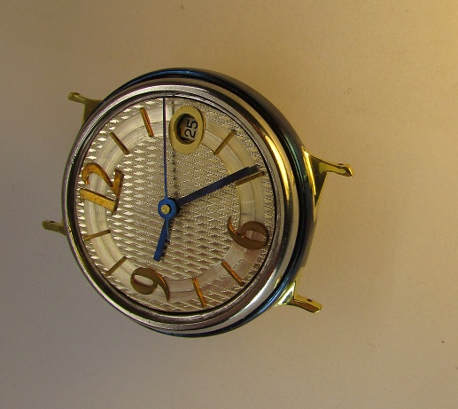

This project has got to the stage where I am getting glad it is over. Anyway, crown made, parts sprayed with clear laquer, acrylic fitted and strap fitted. A few other problems I had to deal with to get the watch keeping regular time. The watch now keeps good time and I will regularly wear it and see what snags come up (which I am sure they will !!)
