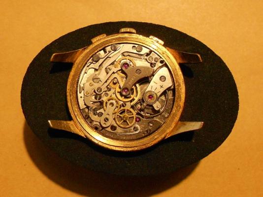

I began servicing a friend's Cauny with a Landeron 248 movement,
post-1304-0-20889300-1458380584_thumb.jp
whose story I am telling here:
http://www.watchrepairtalk.com/topic/3784-a-cauny-with-a-landeron-248-to-service/
But now, after cleaning, oiling and assembling all the parts, I am not getting the movement to work consistently:
When I install the balance wheel the movement starts working, but when I fasten the balance cock screw, even slightly, the balance wheel stops. I tried it several times but always with the same result.
During the movement assembly I verified carefully the run of all the gears, and apparently theres is no abnormal resistance in the movement as when I, (prior to install the balance wheel), move the pallet fork from side to side I can see the escape wheel moving accordingly.
Any suggetion of what might be the problem?
Thanks
I would think it lies with the balance pivots or the pivot jewels from what your saying are the jewels totally clean have you tried running it with out the end stone in place , can you remove the end stone from the front plate? i realise you can't from the balance bridge
You have a end-shake problem, how do you have clean the balance jewel ?
Do you have disassemble the cap jewels ?
May be you tighten the setting screws a little too much.

I agree that this is an end shake problem. Another thing you may want to check is to make sure the balance cock is not bent. This same thing happened to me early on when I started to clean watches, and I had mistakenly put pressure on the balance cock and had bent it slightly (I won't discuss how I did this), so when you screw it down, the end shake was effected.
How i figured this out was to look at the alignment of the balance cock screwed down without the balance being attached. Then it was obvious.
Note: I was working on a vintage Swiss trench watch, so that may be easier to bend and easier to see. I just offer this as something else to check, if it doesn't seem like the pivots or end caps are the problem. I'm not a professional, only a hobbyist.
It could be simply the jewels are upside down or some movements the upper & lower jewels are different. If this is not the case then a close inspection of the jewels for cracks etc & a close inspection if the staff. If this is all OK then it could be a slightly bent staff which should show as it runs. Or was there any packing under the bridge when it as disassembled.Sometimes if a new staff is fitted but it is a little tight a work around (bodge) is a thin packing is put under the bridge.

I didn't disassemble the cap jewels. The base plate was cleaned with the jewels in place. I just oiled a little bit the end stone in the plate. I have inspected it and apparently is ok.
mousekar and clockboy:
The balance cock seems ok to me. I didn't put any pressure on it when disassembling or assembling.
I also didn't notice any packing under the bridge when disassembling.
Perhaps I'll go for a trying with the packing "trick", although I would like a more technical solution, as eveything was running ok before disassembling!

After deciding to go for a  deep new cleaning, as suggested by Geo and George, the result was not unfortunately according expectations!
The problem remained!!
I decided to replace the incriminated plate jewel, which I did... with no success! The balance wheel just didn´t want to run smoothly as it should!
But things would get even worse!!
I was forced to admit that the problem could be on the balance wheel itself, so when I was trying to "persuade" it to work properly, the inevitable happened :
- the staff inferior pivot broke!!
So, i had to face this like making part of my learning process!
And there is no doubt that I will learn a lot with this movement, as my next task will be to replace the balance staff for a new one ( that I have already ordered).
As it is the first time I will do it, I have prepared two scrap balance wheels to try the procedures!! ( I have also ordered a roller removal tool for the job).
