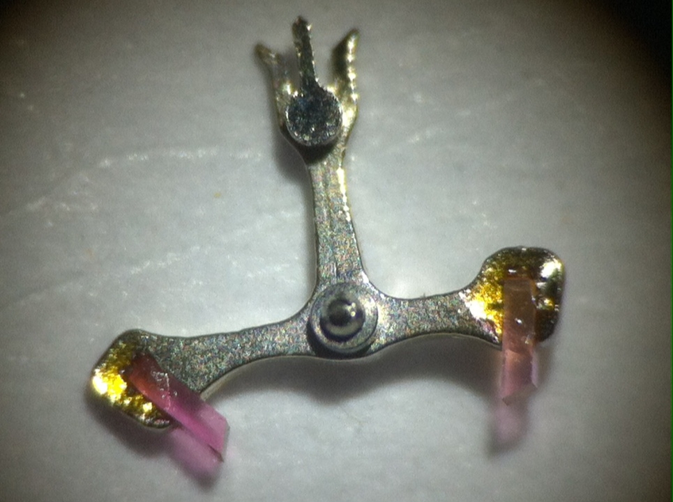

I have stripped down a cheap watch that belongs to my brother in law.  Normally I use Lighter Fluid (Naptha) with a final clean in Isopropyl Alcohol but looking at the lever I am a bit concerned that I do not know what "glue" is holding the jewels on the lever.  Looks a bit like shellac.
I use a simple small ultrasonic cleaner. Parts are put inside a mesh ball and the whole lot is put in a tiny jam jar before getting covered in lighter fluid (naptha) I then fill my ultrasonic cleaner with water and stand the jar in it vibrating away.  I have another jar with Isopropyl Alcohol in it to rinse off in a similar manner and the whole lot dries in seconds.  Everything is on a small scale as I am a Hobbyist not an artisan repairer so I do not buy litres of various cleaners and rinses but I get by and have some fun.
However, the lever manufacture looks a bit crap and I am getting bad feelings.  Does anyone think I should perhaps just not clean the lever and just concentrate on getting rid of the filings and general rubbish on the rest of the movement.  I am starting to lean that way.
Cheers, Vic
No alcohol on shellac,and every pallet fork jewels are glued with shellac.
So dont do it!
p.s: sent from my s****y phone so sorry for typing mistakes
