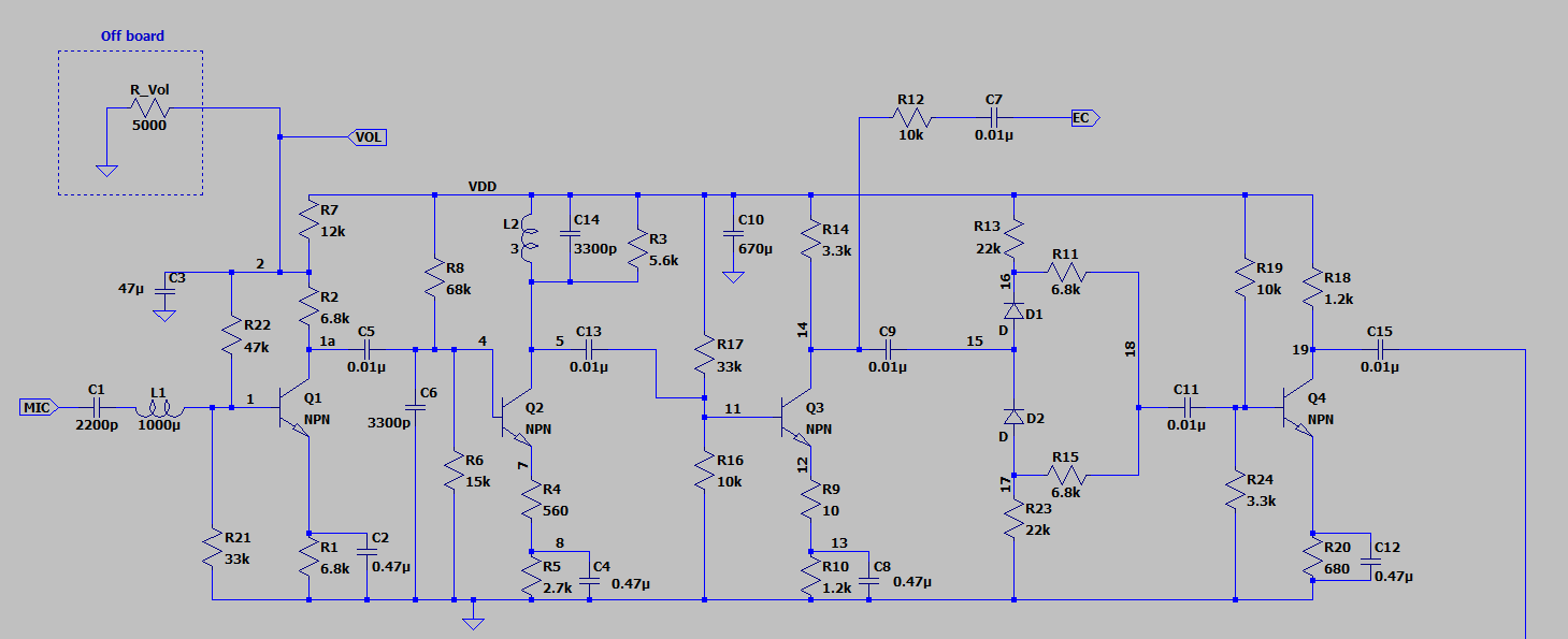

I decided to extract the schematic for the Vibrograf B200 amplifier board so that I can simulate it.  Here are the results of my work.  I have included an frequency response simulation.
I did the majority of the extraction myself, but did benefit from earlier work done here.

4 minutes ago, guidovelasquez said:
Thank you very much for the information and links shared. I only have one question: What does the two curves on the graph mean?
The darker blue is the magnitude in decibels (the scale is on the left side).  The lighter blue is the phase shift in degrees (scale on the right).  You can ignore the phase plot.  The magnitude plot is most interesting.
This extraction happened because I was puzzled by differences in my Weischi and my Vibrograf.  It is all resolved now and have complete understanding of how the Vibrograf does its magic with gears, double helix (perhaps a misnomer...a helix with two oscillations on the platen) and motor.  Done all the calculations for the beat frequencies and I am now satisfied.  Fascinating.  It is a well-engineered machine.  I like it.  Only wish it were a smaller footprint!!

36 minutes ago, LittleWatchShop said:
fase en grados
Very well thanks. She hadn't seen the scale to the right of phase. I assumed that everything ran in decibels. and that the horizontal was that of Hz.
Excellent document. Particularly the answer in herz of the graph.  Confirms a conclusion that we had reached empirically. That the frequencies above 1Khz are the most important in the measurement. And the graph makes it clear there is a strong attenuation at frequencies below 1Khz.
