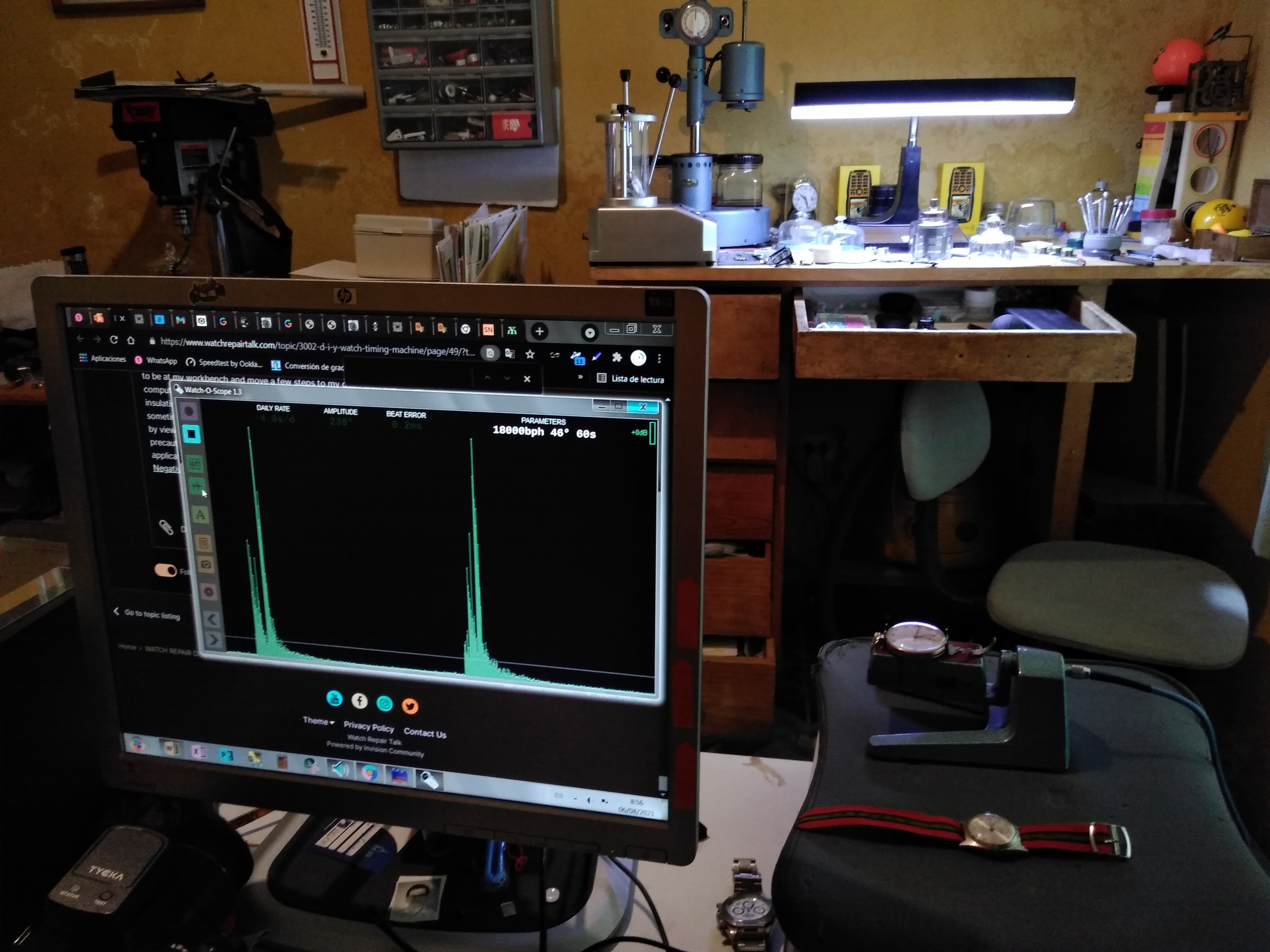

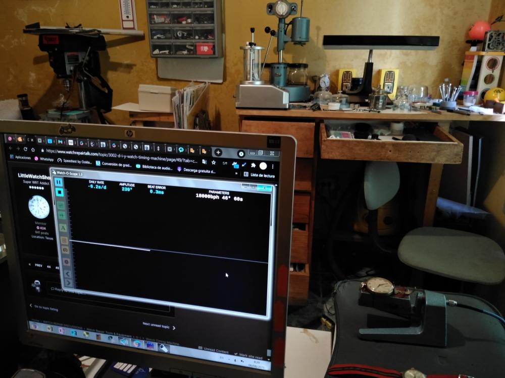

You are right @LittleWatchShop And it is understood that in some parts the problem of space is very complicated. In my case the problem would be the cost of buying a Weishi. Although it is one of the cheapest. But with the modest investment that goes into building the preamp and an acceptable mic I am very satisfied with the W-O-S software. It's everything a watchmaker could even dream of in the golden years of watchmaking let's call the 60s 70s. There were tools in those years. But compared to what WOS can do, they look like toys. Here I share a photograph of my workspace.
I will apologize for the mess that is appreciated. It is the entropy related to the precision of the clocks. This configuration allows me to be at my workbench and move a few steps to my desk with the computer where I have the microphone stand with a padded insulating support and from there make the readings and sometimes taking my magnifying glass and a tool, do the settings by viewing my computer screen. It is not ideal, but taking precautions is functional. And I explain the black screen, I use an application to be able to invert the colors of the monitor. NegativeScreen.

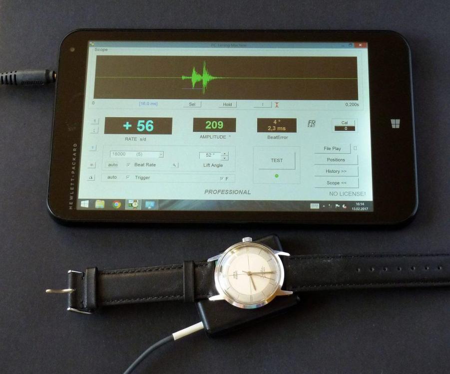

On 8/8/2021 at 2:56 PM, praezis said:
A win tablet PC is what you want.
Some pictures to illustrate my short statement. Doesn't take more space than a TG, imho.
Any Windows program / TM software will run on them.
Old 10" tablet with TIMOMAT microphone
7" tablet with PCZW microphone
Frank
Frank
Very nice idea.  Guessing that the software supports stylus or touch input so that a keyboard is not required...
Not needed, any tablet / OS does. You need no special software, as mentioned.
Frank

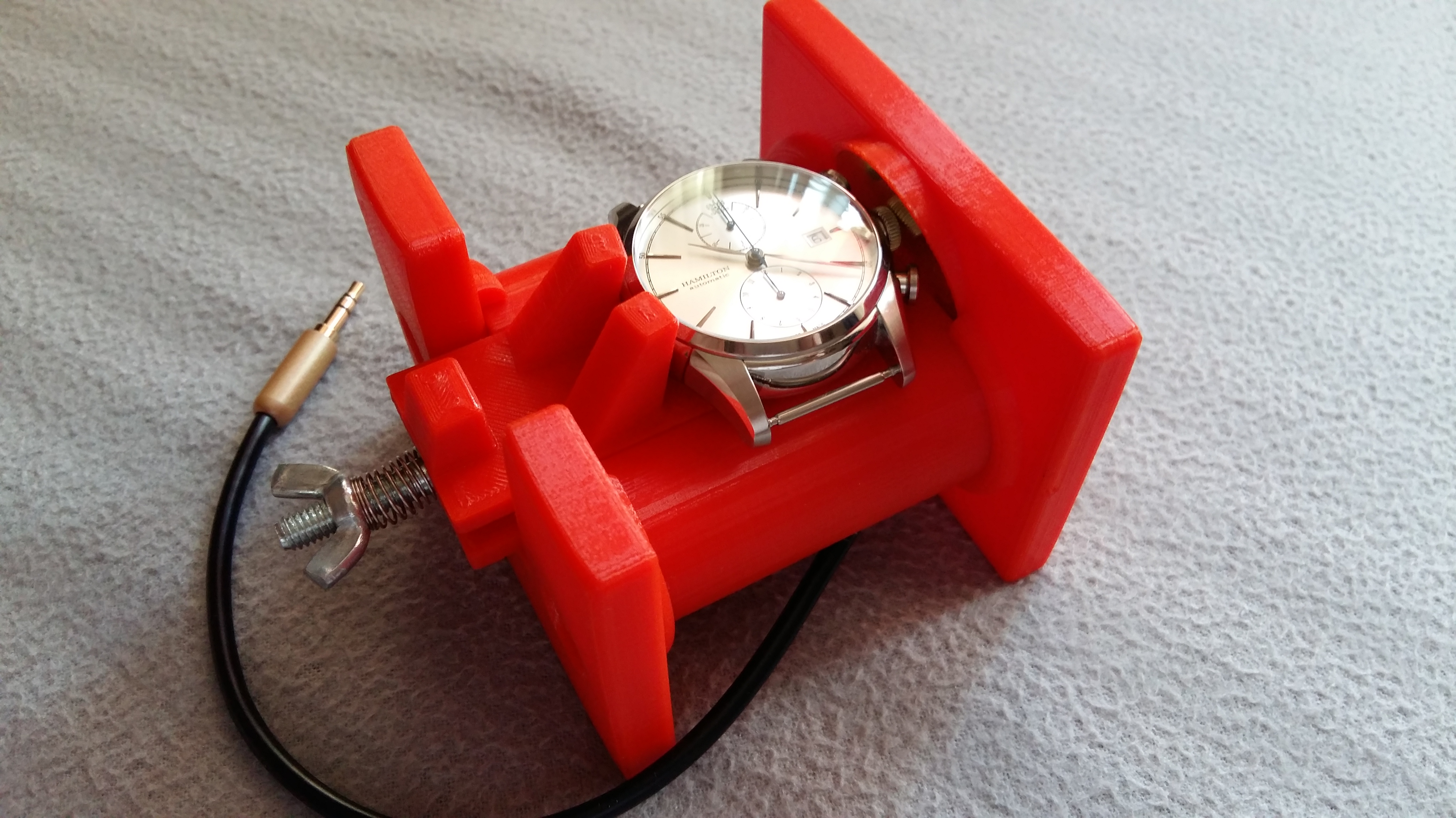

On 3/7/2018 at 11:14 AM, matabog said:
Hi Maya big nice work. Can you please share STL files.
I made a new version... The problem with this 3D print design is that it gathers too much noise from the environment. Ideally you need you sensor stuck to your watch/crown, then some soft/insulator/dampen material, the a heavy support.
So I modified it a bit for the sensor not be glued directly with superglue by the plate, but with a layer of foam-double_side-tape. Also I decreased the plates sizes a bit because not all the bracelets fit.
I also put a hole in the back plate, in the sixth position :), for the cable - I didn't like it exiting through the side, it was in the way.
Note that only the side pieces were modified, so for the ones that printed the old version, they dont need to print again the entire project, but only those two parts.
sub_1.thumb.JPG.4836123ce8544b6f4c8752a537eb91e9.JPGsup.thumb.jpeg.135a5edac2ad07f1c7d8aee33e80c937.jpeg
