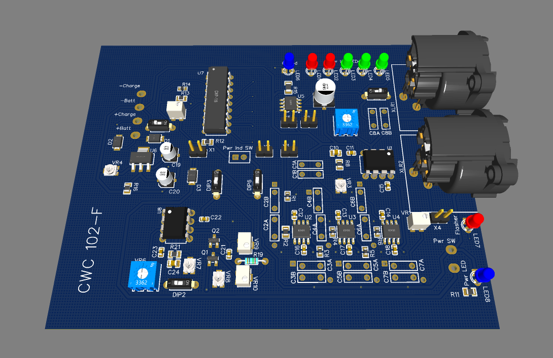

This is my new streamlined prototype amp.  I made a version of this myself using my CNC router and it works very well.  The new board will be using surface mount components for most of the components and the rest I can solder on myself for testing.  It has several test pins/pads and extra places for components.  It also has several POTS/Variable resistors for testing different values.  I'm having several of these made.  I wanted a board that I could use to test different components and values more easily, while keeping the size small enough. (92.0mm X 120.0mm roughly).  Not very inexpensive nor is it simple but it works well.image.thumb.png.e2bda4a41419768bf745d5f3d2a2e95b.png

Not Huge cost but there are minimum orders for many components.  Making the board yourself is cheap but very time consuming.  A lot of fun, and a wonderful learning experience for sure.
4 minutes ago, guidovelasquez said:
In other words you can't build it in 30 minutes, with a home depot soldering set, and 20 bucks....  But it is a very doable project if one has a few decent tools and a bunch of time....
