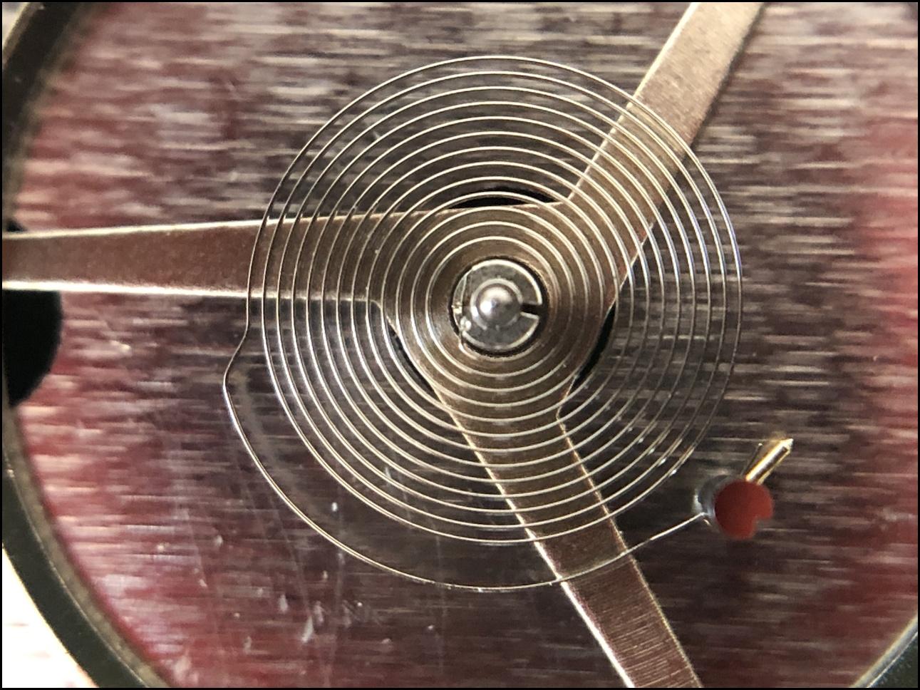

Exactly. This is a pic of the hairspring I'm working on. My horizontal v vertical rates are all over the place. There is no discernible terminal curve. My problem is that the outer coil is (possibly) hitting the regulator pin. It's hard to tell but it looks to be getting very close. Also getting close to the stud, which could be @VWatchie's problem.
You can see that I need to adjust the inner coil to centre the collet. That will hopefully solve the problem. But then I'll take the spring off and attach it to the cock to see how it looks.
I don't know if it's causing your problem @VWatchie, but I would say your inner coil looks like this

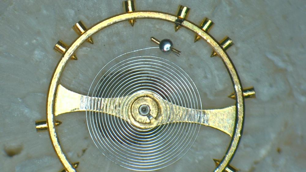

13 hours ago, VWatchie said:
Funny that you should mention it! I just stripped the entire movement and when unscrewing the train wheel bridge, I noticed that I hadn't secured the screws. They weren't exactly loose, but not one bit tightened. However, the bridge was pressed down all the way. Before tightening the screws I always make sure the pivots are in the jewel holes and that everything spins freely and looks right. I simply must have forgotten to tighten the screws this time around. What kind of impact could this have had? I believe I remember @nickelsilver mentioning it "being a crime" (or something along those lines) not to tighten the screws very hard when he was in school. I didn't think much of it when I read it but perhaps it was a reason for it, no?
As can be seen in the picture and hopefully in the video I tried to adjust the terminal curve to the best of my ability. Not perfect, but at least a bit better than it was. It had no real effect on the problem with the hugely varying rates between the horizontal and vertical positions though. So, I have decided to strip and re-service the movement. I only had the time to strip it tonight, but hopefully, I'll find the time to keep working on it in the coming days.
I've tried to do my very best to get the utmost coil to collide with the stud. However, there is a very healthy distance even when I rotate the balance nearly 360° to expand the coils as much as possible.
Here's a little pixel measuring experiment:
Follow the spring clockwise from the red circle. As we progress towards the outer coil the distance should gradually increase somewhat provided the camera is held perfectly parallel with the spring, which it was not, but let's ignore that. Looking at the numbers I would concur that the collet isn't centred.
CoilDistanceVWatchie.thumb.jpg.b4c0c6c4754655cc3c3a0dcbf813e797.jpg'
Again, follow the spring from the red circle, but this time in a counterclockwise direction. As we progress towards the outer coil the distance should gradually increase somewhat provided the camera is held perfectly parallel with the spring, which it was not, but again, let's ignore that. Looking at the numbers this time, however, I would say that the collet is reasonably centred.
I have two things to say about this.
Firstly, I don't think my hairspring needs any tweaking and it's my impression most of you would agree, but I would still appreciate hearing if anyone has a different opinion.
Secondly, and this truly surprised me, Mike's spring is coiling in a clockwise direction when we follow it from the collet, whereas my spring is coiling in a counterclockwise direction when followed from the collet. Is this normal or is your picture mirrored, Mike? I have never reflected on this but if someone had asked me about this I would have said that all hairsprings are coiled in the same direction.

Yes, the hairspring is not perfrctly centered. But it is not enough to cause 'touching' to the collet. It makes the hairspring center move in circle and this movement is partly transmitted to the outer coil, making it's distance to the studd to change in odd manner. But if You don't see any touching to the studd (this distance never gets dangerously close to 0), then no problem from that. But for the sport, You can try to center the spring at the collet.
There are left hand and right nand wound springs, this is normal. The layout of the movements are different.
I meen graph that has amplitude for one axis and rate for the other. May be the graph then will be not line, but something like cloud of dots.
I have to agree with your numbers, it is centred.  The shape of the first coil makes it look off centre.
I too had not thought about the direction of the springs.  It depends on which way the balance cock points. Yours points clockwise, hence the spring must be anti-clock for the stud to be on the outside.
Mine is the other way
