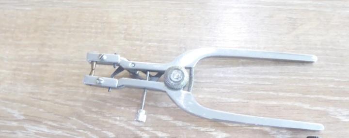

A Levin hairspring truing caliper and a Swiss simple caliper that works well too
These as well
4 minutes ago, Neverenoughwatches said:
These as well
They can work, but you can see how extreme the Levin is in removing the maximum material on the caliper above the spring to allow proper viewing. The Swiss one has more material but works- though it is less handy than the Levin.

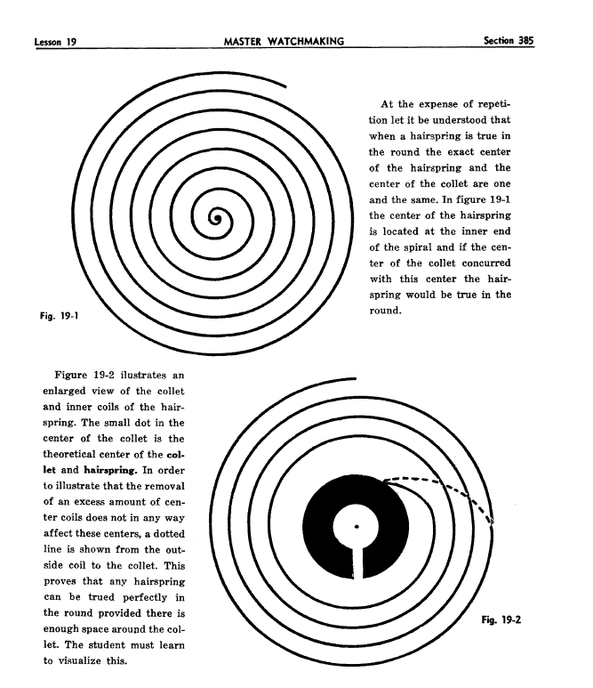

One of the basic reasons has it's roots in the formula for the real balance-hairspring system own resonant frequency, which is long and complicated formula that shows that free oscillations actually are not isochronic.
Here is a page copy from old book for watch regulation theory, which shows different cases of ange beginning/end of the hairspring and the way this angle affects the rate.
Well, this is in Russian, but the vertical axis is 'gain/delay' in seconds per day and horizontal axis is the amplitude in degr.
So, what is imortant here is that if the hairspring shape is chosen correctly, it will be able to compensate the escapement effect on the rate when low amplitude and thus relatively isochronical work will be acieved. And if the hairspring is simply 'vibrated', with no idea of what angle beginning/end will receive in the end, then easily a difference of entire minute per day in vertical/horizontal positions can be achieved. But, this is the designer's duty. If it is regular balance-hairspring couple from the manufacturer, then such problem would not exist.

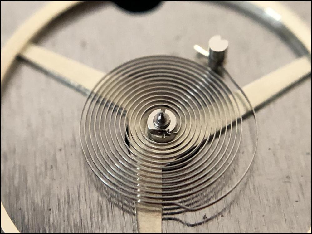

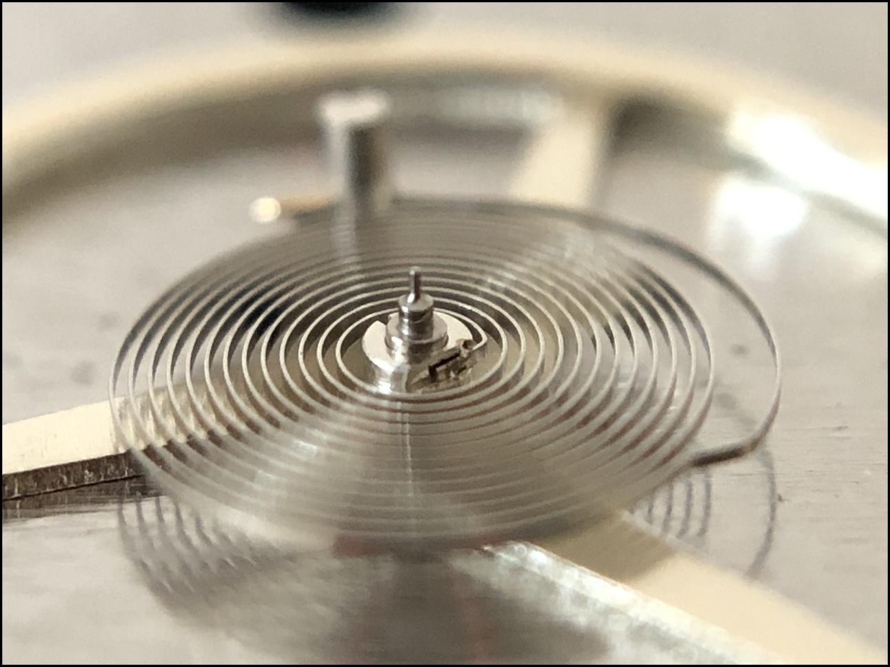

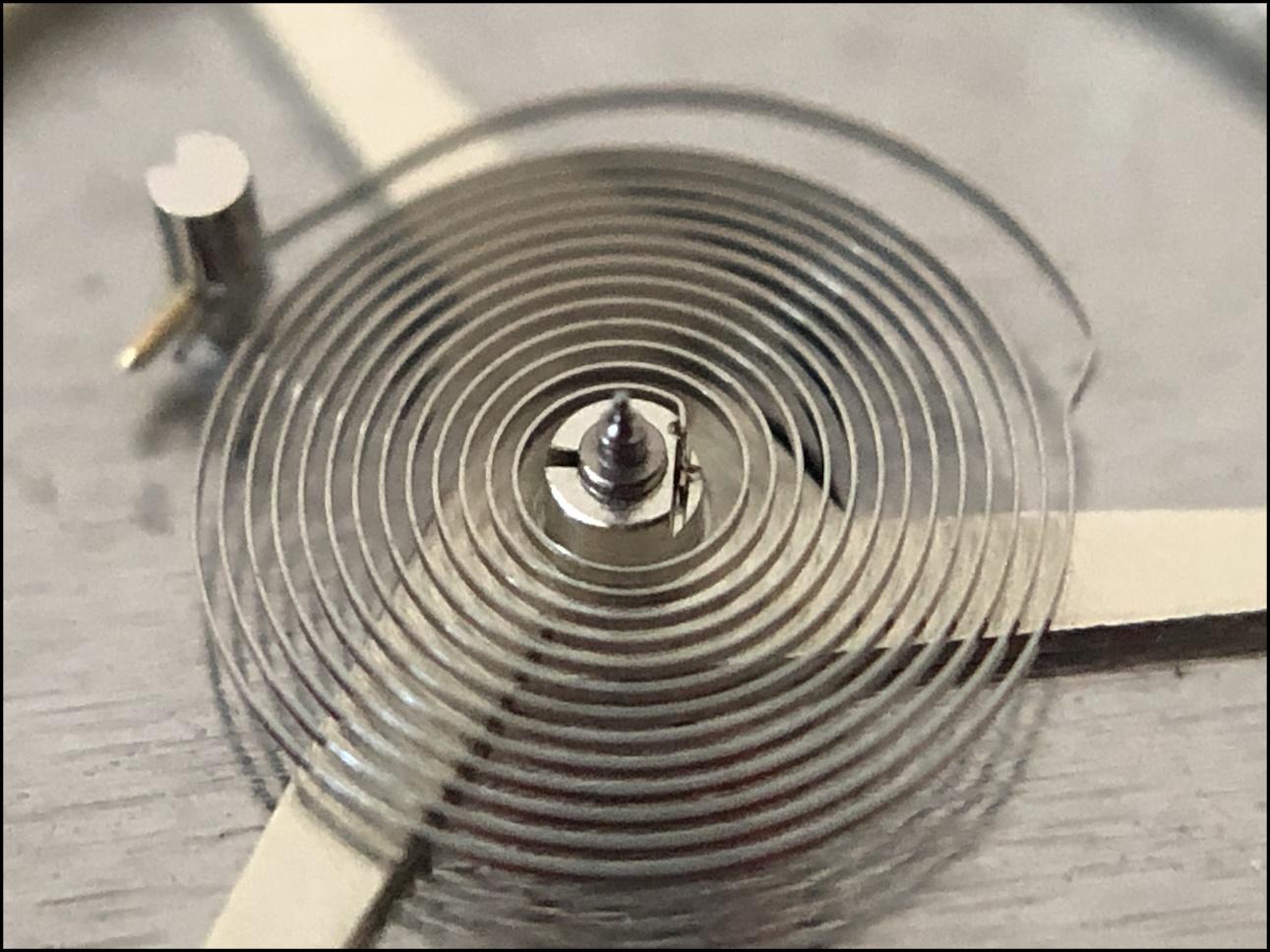

The most probable reason in You case would be that the hairspring touches something and thus gets shorter when big amplitude. This 'something' well can be the collet, if the hairsprinfg is not centered there. To see if it is the case, we will need picture of the hairspring where the collet is seen. So, remove balance from the cock, put it hairspring up and make a photo of the hairspeing
This is new territory to me so I don't know what to make of it. The pictures were shot through my phone's macro lens so they aren't perfect. Anyway, looking at the hairspring through my stereo microscope, it looks like it has been attached to the collet by moving material from the collect over the hairspring. I never saw that before but as I don't have a ton of experience it could be anything from just right to dead wrong. I can't wait for your input!
I cant see exactly what you are seeing watchie, but i have worked on a lot that were not pinned.  Only way i can describe it is a slit cut into the side of the collet, the hs is then put into the slit then closed up and the hs trapped inside it
The position of the two pinning points looks like the second diagram down from nev's post which would give the least rate fluctuation over variable amplitudes.
Terminal curve loks to be heading into the main coils.
That's what it looks like, yes!
Yes, but I don't know if that is a problem or would explain the huge differences in rate (as previously described). I do hope @nickelsilver and @nevenbekriev will share their thoughts about what they see.
The first thing I'd do is fix that terminal curve, so you have the same gap all along it. It must be distorting the hairspring when mounted. - bringing the outer coil too close to the stud. Possibly hitting it at higher amplitude.

OK, I can't see something criminal near the collet. At least, no touching can happen there thow I was thinking this possible.
Then, the angle beginning-end is between I and II diagram, and such angle will make the movement work faster when low amplitudes and slower when high, so this choice is the best for the way the movement behaves, and if changed, the problem will only get depper and worse. So, seems that there is no problem here.
Then the only point I can think of where such behavior can be caused is the studd where the hairspring can touch in high amplitude. So, please, assemble the balance again in movement and manually move it in direction so the hairspring expands to the maximal angle - 330 degr or so, and look at the distance between studd and hairspring and if it will touch the studd in some angle. At this moment I can't see another possible reason for this behavior. The terminal curve is really not perfect and can be rectified, and this must make the studd stay a little bit away from the hairspring
Adjusting the hairspring end to look „nice“ makes no sense by itself. More important is the distance stud - center which must be the same on cock and hairspring. You may spoil this by adjusting to „nice“ on the separated balance.
Didn‘t you write above that you opened the regulator gap? That can make your issue worse.

 This is what I understand from Franks statement.
What matter is:   the concentricty of spiral ( near the stud inclusive )  when balance complete is installed in the movement and adjusted.
A spiral  that look perfect when out of the watch, often needs adjustment when installed in the movement.
VWatchie, Sort out the mess thats near the stud, install and adjust the spiral for total concentricity.
Rgds
Thank you Joe, you got it!
What I meant: you can adjust the terminal curve to look perfekt concentric, but you will alter the distance of the stud from the collet center. Back in the watch/cock this may distort the hairspring.
Maybe this ugly terminal curve gives the correct distance.
Frank

Mike, You mean like this,
  A routine approach for truing the spiral , this is alright  as long as spiral  remains concentric, as you do the rest of making  a balance complete.
