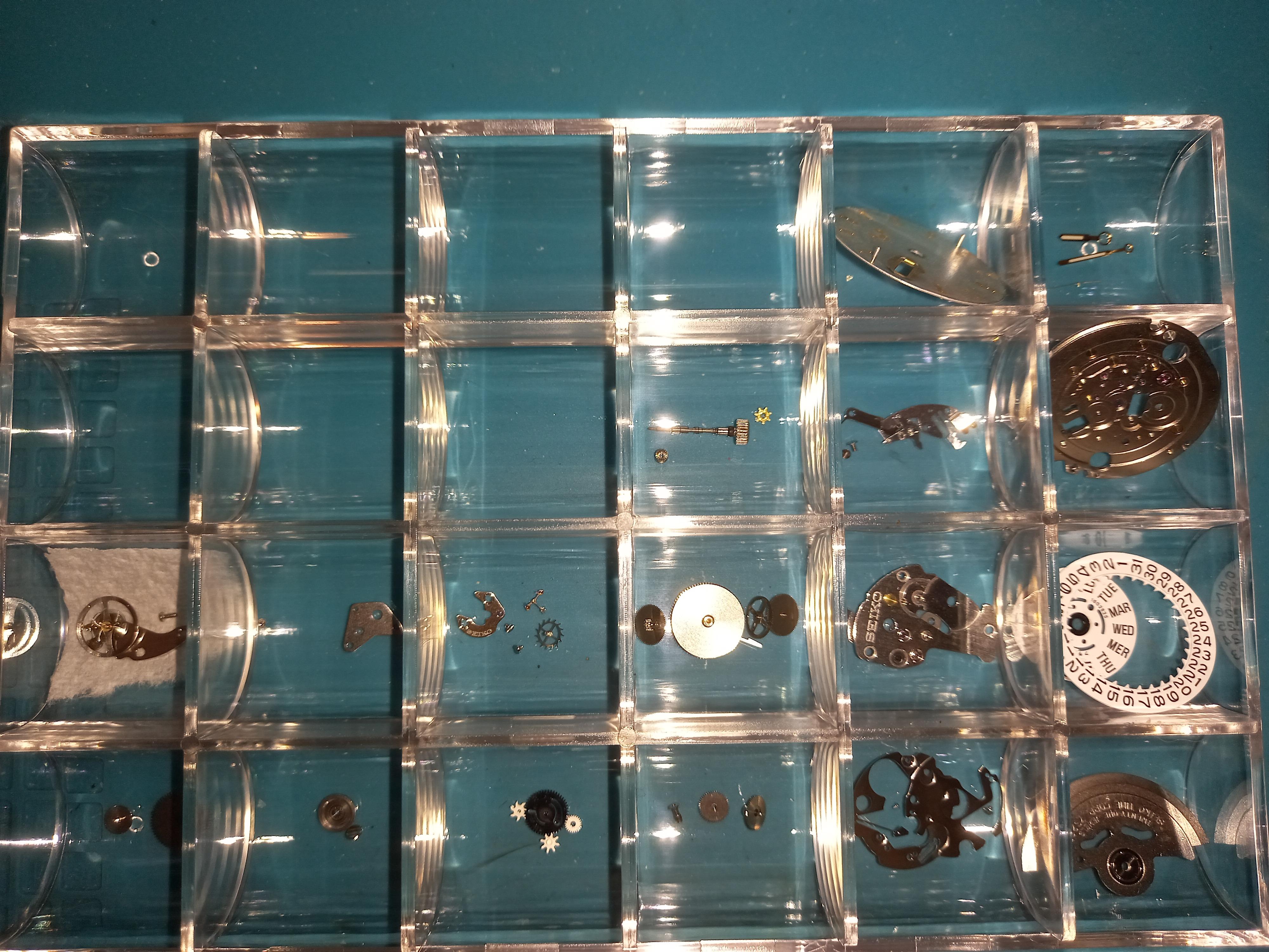

All items in baskets and into jar 1 (lighter fluid). Jar into warm water in Ultrasonic machine. 3 cycles of 2 minutes.
Shellac items removed. Tweezer dipped into Isopropyl and liquid dropped onto items by opening of tweezers. Blow dry with hand air bellow after 20 seconds. Watched carefully to see iIsopropyl being evaporated around shellac asap.
All other items into jar 2 Isopropyl. 3 cycles of 2 minutes .
All items.  Blow dry in heater 10 minutes.

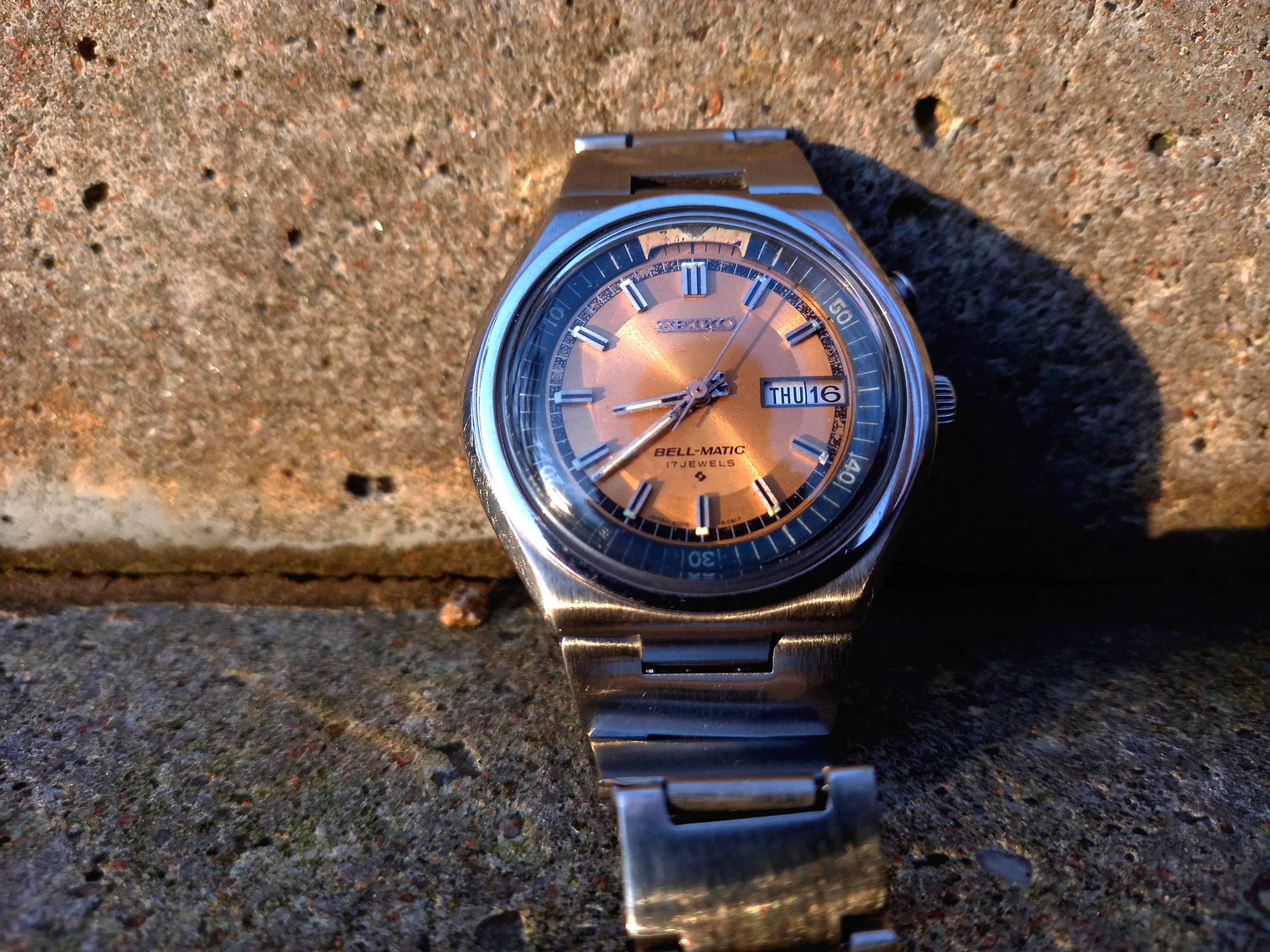

10s 153 Ampitude 0.3 beat Error.  Adam's is 271 Amplitude
Runs well. Worn for a week every other week.
