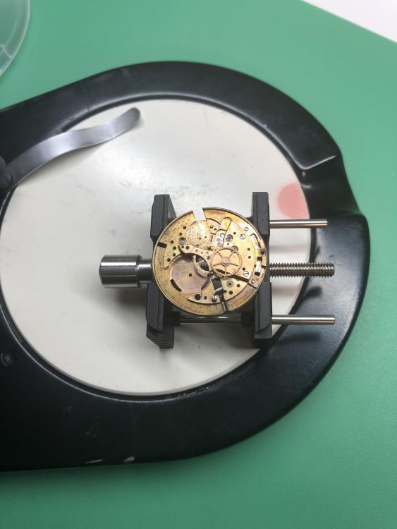

Hello watchfriends, I have serviced an Omega dynamic caliber 601. After reassembly the watch runs very nice for two days. After winding it again it won't run???? It seems to be very nice in beat. After removing the pallets, the wheels seem to run freely.  What can cause this suddenly problem. Could a bad mainspring be the problem?
Thank you all for your help in advance.
Hi a little bit of history on the watch and also some pictures.  From what you describe it may be a bit of floating debris. Bent tooth cracked tooth binding mainspring in the barrel, the list could go on ,  best approach is to dismantle again and inspect each bit as you put it together, did you remove/replace mainspring, ?  Best guess mainspring binding as it only occurs when you wind it up again check it out,  if you re placed/refitted mainspring did you use a winder or your hands.
Hello Watchweasol, I didn't replace the mainspring, because I wanted to know if the watch would run at all. I used a mainspringwinder to refitt the spring.
In the meantime I have ordered a new spring.

Unlikely the mainspring causing that sort of problem, unless the end has broken. Can you feel tension as you wind?
Do you have a pic of the old mainspring?
Is it running with dial and hands on ?
As you have ordered a mainspring we will start with that, make sure the barrel is clean and lubricated, check thr barrel bearings for sideshake causing a miss lock and barrel teeth for wear , bent , or cracked, when spring fitted  go from there

Also assemble the train wheels (no pallet and balance)and put about about a half wind on the ratchet wheel. The wheels should spin.. once they stop, try to help them restart by using an oiler on the spoke of one of the wheel.. if it runs a bit you have a power transmission issue.

Hello, I took some time because of vacation. I cleaned and lubricated the barrel (looked okay) en placed a new mainspring. I assembled the movement (wheels where running free).  I gave the movement a wind and it started running very well. After about 48 hours the watch stopped running. Again I gave it a full wind and it started running. Again for about 48 hours. But now, after about 25 hours it stops running. I have wind it again, and now I will wait how long it will run.  Probably the mainspringbarrel causes this problem anyway, I think.
Hello Nucejoe, thank you for your advice. Is this a common problem with the 601? Is replacing the second pinion (with gear) the solution? Causes this strange spring the problem?

 The center hole of minute wheel somewhat wears out with every remov-replace, plus some risk of bending the extended pivot of third wheel or distortion of minute wheel.
Peening the center hole often works, minute wheel can be poised, but much can't be done to un- wear the wear caused by remov-replace.

Well, no. It is not the mainspring.
You have to learn how to investigate such unexpected problems.
Most important here is to open the back verry carefully so not to cause the movement to start working again without haveing oportunity to understand where the problem is.
Then, You need to understand if the escape wheel is powered or not. If no momentum goes to the escape wheel, then balance will be able to oscillate several times from gentle shake, the pallet wil move from one side to another and the 'scape wheel will move a little forward and reverse, but this movement will be causet by the pallets and not by the train. In this case, the stopp is somewhere between the mainspring and he escape wheel. In some cases momentum may go to the 'scape wheel, but reduced and not enough for keeping the work of the escapement. Then shaking will make the movement work, but with small amplitude and may be it will stop again soon. And may be the amplitude will start to gain and after some time, it will rise to normal.
There is another group of problems, that are connected with the escapement itself. For example: the balance seems blocked in position different than it's zero position, and even strong shake doesn't move it. Forcing the balance to zero position or taking it out and putting it on again unlocks the escapement and the movement starts running normally
So You first task is to understand which group You have
Is it just the bare movement or is it in the case with the hands dial etc.? Then I don't suppose you have access to a timing machine? Really nice for diagnosing running problems helps to show things you can't see with your eyes

Just to be clear. I studied how a timepiece works and how you can detect and repair malfunctions. For example, I followed, among others, the full training with Mark Lovick. So normally I can search for errors in a very structured way and then fix them. But you encounter situations where knowledge/experience is insufficient. Then it is very nice to consult and learn from forums like this.
In the meantime I checked the Omega 601  for 6 days now. The first time it runs for 38 hours, afther the secon full wind its runs for 46 hours and after the third full wind it runs for 48 hours.  Perhaps I was to impatient after the service (new mainspring).
