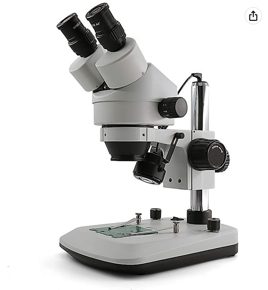

Yesterday I received my new toy, a "Swift" 7x - 45x zoom stereo microscope.
It opens a new world with things I wanted to see, and things I actually didn't want to see.
I can now clearly see if an escape-wheel teeth drops on the locking-face of a pallet-jewel and not just on the edge or just on the impulse-face. I can clearly see the pivots of a balance staff. But now I can also clearly see the grime, fibers and other residues 😳
Question is; do I become more or less happy if I were to increase the magnification range with a 2x Barlow lens from 14x - 90x?
My reservations are that I may start to chase ghost, things which may look "horrible" under 90x magnification, but in the scheme of things aren't that important or worse, those things I can't do anything about anyhow but are just troubling my mind?
What are your experience with up to 45x magnification? What do I gain with higher magnification above 45x? When is enough = enough?

The Swift I have (S7-BL) has a working height of (actual measured) 100mm at 45x magnification (It's a zoom). Of course the working height would 1/2 with a 2x Barlow lens. If I were to get a 0.5x Barlow lens, I need a small step-ladder in order to look through the scope 😆
The 20x eyepieces are of course another option, any pro's & con's with that ?
Assuming that you are right in saying that the "most of us" are using a magnification range of 3.5x - 22.5x, than there would be no need for me increase beyond 45x .... Yes/No?

What I like about this setup, with a seamless adjustable LED in the bottom of the stand, is the ability to check jewels, pallets etc. Yes, it adds somewhat to the height, but to me worth it.

Yes, that's something I like to consider. I guess a 144 leds ring-light will suffice? I would be nice though, when the ring-light could be hooked up to the same adjustable power-supply currently used by the overhead light ... The base has two potentiometers, one to adjust the bottom-, the other for the top-light.
  On 3/21/2023 at 2:06 PM, spectre6000 said:
That scope looks like it's from the same factory as the AmScope
Expand
Yes, I guess there is only one factory, producing the same scopes for a 1000 different brands..... 😁

The Swift microscope I have has a "lens" outer-diameter of 54mm. Looking for microscope ring lights, there are the "general-fit" ring lights with an ID between 9.5 - 10cm, but for only a few Euro's more I found (and ordered) a ring light with an ID of 61mm. Seems to me a neater fit.
My scope's seems to have a 5V PWM power-supply. The ring-light seems to require 12V. I desperately try to avoid additional cables running across my desk ....... so, within a few days after arrival of my new scope, chances are that I've to void the warranty already 😱 😊

Yes, I may. But the scope has already a 100mm working height. Doubling that to 20cm and I may have to apply for a neck extension 😁

You were perhaps looking for another scope, the one I have may be a very good option?
Swift S7-BL €313 with a discount voucher, Amazon.de
Oh yes, you were right and I do have one regret ! Not buying one earlier 😁 👍

The head-piece on my Amscope microscope looks like yours. The working depth I gave (~150mm) is from the desk to the bottom of the Barlow lens + light ring adaptor, at maximum zoom 22.5, (10x eyepieces).  At min zoom, working depth is about 180mm.
In this config, the eyepieces measure 40-43cm above the desk. I'm not tall, and on a high seat, I find this ideal.
A movement on a holder is about  20mm from the bench. Screwdrivers about 90mm, tweezers 120mm. So to work under the microscope with screwdrivers you need 110mm + some working depth, say at least 30mm. With the 0.5x Barlow this is fine. For general work, I generally use near min zoom, only using max for oiling pallets etc.
I just removed the 0.5mm Barlow, and on min zoom, the working depth is about 110mm, i.e. you cannot use a vertical screwdriver, and I find it too much mag for general work.  Also the eyepieces are a bit higher.
