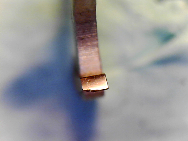

While manipulating the entry-& exit pallet jewels of an old lever pocket-watch, the impulse face of the entry jewel chipped. The exit-jewel is worn too, so I like to replace both jewels.
CousinsUK has a nice selection, but I'm not clear about their sizing 🤔
The jewels I have are 0.3mm x 0.5mm, the 0.3mm being the part which friction-fits in the fork-slot. Any bigger and you can't slide the jewels in, smaller the jewel drops out.
What does CousinsUK understands with "Width", in my case the 0.3 mm part or the height of the jewel, the 0.5mm part?
And if "width" is the 0.30mm size, how "high" is the jewel? (I need for sure the 0.5mm or slightly more)

Entry-jewel with worn edges and scores over the impulse face;
Exit-jewel;
We have to see how the movement runs on new stones ....

The new Bergeon pallet jewels have finally arrived (took 3 weeks from the CousinsUK to DK). The old Garnet pallet jewels measured 31x50 (that is 0.31x0.5mm). With the escape wheel running on the low side of the jewels (as can be seen in the pictures above), I was hoping to get 31x60 or so. CousinsUK only gives the size of the fork-slots and the height is determined by Bergeon (discussed above).
The fork-slot size 31 wasn't available either, so it was either 30 or 32. To be sure of a fit, I ordered 30 and they indeed slide in, but with hardly any resistance.
The problem is the delivered height; only 40 (0.40mm). The height of the fork is 50 (0.5mm) This means, when the jewels are installed flat on the underlying surface, that the escape wheel will run on the edge of the jewel or even lower.
Adjusting the running height of the escape wheel is, in my eyes, problematic having burnished jewels.
When installing the pallet jewels, the fork (50) lays upside down and to ensure that the escape wheel teeth are hitting the jewels, the 40 jewels have to be installed on the high-side of the fork, leaving at least a 10 (0.1mm) gap underneath. Of course it would be even nicer if I could install them with a 15 gap, but lets first try to achieve the bare minimum.
Question is; how am I going to do that while ensuring that the jewels are installed horizontally? 🤔

Just an update on how I got on with the pallet-jewels of CousinsUK, or rather Bergeon.
As described above, since the escape-wheel was running on the low side of the fork-jewels, it would have been nice to get jewels with the correct fork-slot size and higher than the thickness of the fork. The jewels would than "stick-out" underneath the fork when installed, covering the escape-wheel teeth fully. I didn't get the desired jewels, so some improvisation had to be done.
In order mount the jewels higher (or lower if you wish, with the fork in the correct position) a 0.2mm SS-wire was used as a temporary "filler" underneath the jewels. This worked very well.
Not having the jewels with the desired height, it was a total pain having to use these "filler-wires" each time the setting depth of the jewels had to be adjusted. Not having the proper equipment either, it took me many, many times to install the fork, check the setting depth, taking the fork out, place it on the pallet-warmer, insert the 'filler-wires, heat everything up and adjust one jewel at the time.
Initially the comment @nickelsilver wrote (https://www.watchrepairtalk.com/topic/23176-1975-omega-861-amplitude-after-24hrs/#comment-196690) was above my head. But now, after having played for days with these jewels until I finally got them right, I fully understand what he, and @JohnR725 said.
Drop-lock, draw (run to banking), total lock, horn clearance, safety-pin clearance and very important: moving one jewels effects the other, have become fully clear to me.
A very important lesson learned and I realize now that adjusting the jewels on the 1975 Omega 861 isn't going to be as easy as I initially though. The Omega has a shallow total lock on the exit and a heavy total lock on the entry jewel. Pushing the entry jewel in means extending the exit-jewel.
Anyhow, the new Bergeon jewels are installed at exactly the correct height, or low, so the escape wheel teeth do run fully on the impulse planes. Now I can concentrate on the balance timing screws 🙂
So, thanks to all for your excellent help and wishing you already a very prosperous 2023 !!  😉
