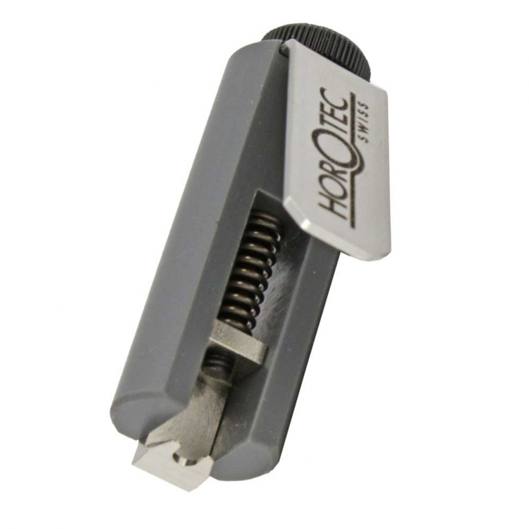

Has anyone come across a cheap alternative to the Horotec/Bergeon crown extractor? I can't seem to find one on Aliexpress but I may just not be able to find it.
I wasn't even aware there was such a tool so thanks for sharing! The only tool I've seen for this purpose is a presto tool as seen in the below picture.
Bergeon 4344.9 - "Presto" Tools
A few AliX vendors have this clone Horia tool.  Besides the jeweling anvil pump set it comes with a set of handsetting attachments.
Has anyone used one of these?
