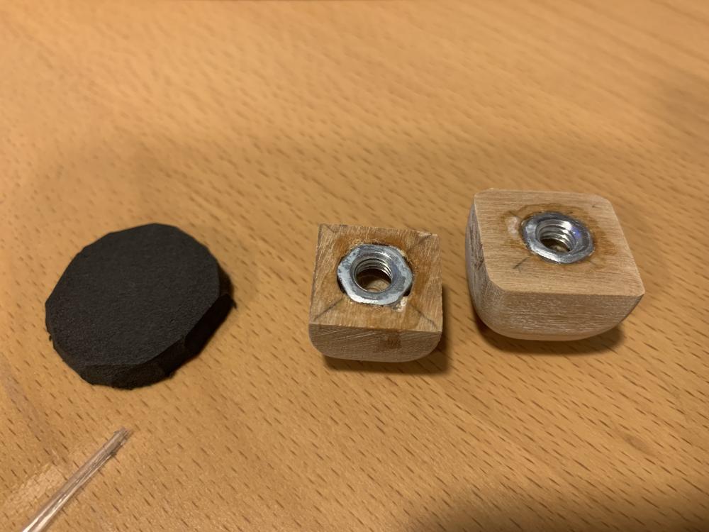

I think it would be quite easy to make your own dome dies. Just embed a correct size nut into a piece of wood or plastic and turn it down in a lathe.
I think our brains are connected HectorLooi 😅. Although you would need a wood turning lathe and turning chisels. I just so happen to have started dusting mine down yesterday 😉
Edited by Neverenoughwatches
I was thinking about a hi-res 3D print in nylon, sanded smooth. But it would need good structure behind it to be as rigid as the machined acrylic dies.

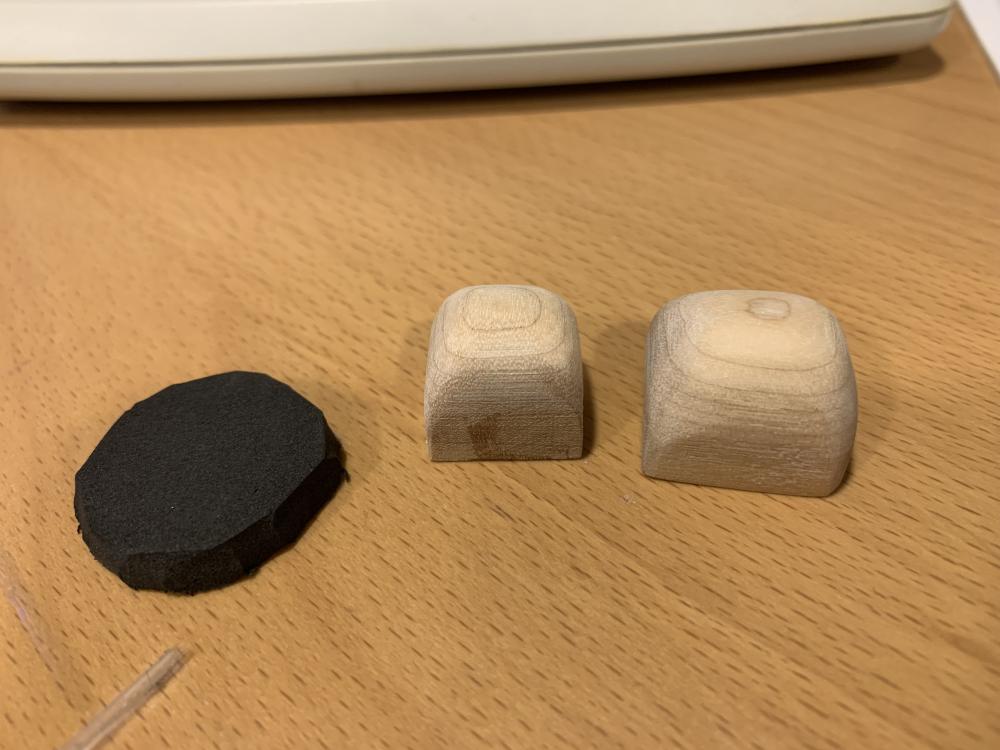

I actually did this a few days ago to put my 1st acrylic dome in. I have one of the cheap lever style chinese presses. I sanded down some scrap wood, put an M6 nut into the back and just used some super glue to hold it in. I put a small piece of foam over the dome when pushing on the crystal.
Without the foam, I broke a crystal, but I chalked that up to also being too large and being the 1st time I have tried this, was using way too much pressure to make the larger size fit. The smaller size down is the one that ended up fitting.
Edited by Charette
  • Like 8
Keep the ingenuity flowing .👍
