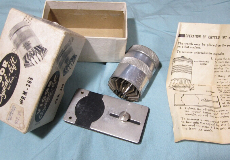

Just thought I'd toss my "review" in there about cheap Ama/Bay crystal lifts. Just FYI
I got one a week ago and tried it out. It simply will NOT grip a crystal enough to do the trick. The crystal I used it on seemed perfect, i.e. nearly 1/8" straight sides before it bent over to the face. Should be perfect for a crystal lift, but the chinese one just slipped off this crystal and was almost totally ineffective. I eventually pushed down very firmly and cranked the grip enough to just barely get the crystal off the case. Would be impossible to lift a crystal with any taper to it.
I subsequently found a used Vigor a couple days later for just a few dollars more. It was in fine condition and it gripped the same crystal with nearly zero effort enough to function very well. Night & day.
I would think a guy could dress the chinese gripper ends to better grab crystals but don't know for sure. I'm positive you could improve them some amount. But seems like good "real" ones are fairly commonly available on eBay for similar money, at worst just a few bucks more.
Cicom: $16.50 tmd
vs. Classic Vigor: $21+ $7 shipping
For what it's worth

The problem with the Chinese one you got is that the fingers although brass coloured are actually made from Aluminium so cannot grip hard enough to squeeze the crystal, if you shop around there are much better ones from China with much harder fingers  (possibly stainless steel) which do work well.

me being a machinist, given only those two choices, I would prefer the fingers be made from Al instead of brass anyway. brass is soft too but is slippery while un-anodized aluminum tends to be grippy. So the problem isn't that they faked the brass look, but rather that the
'brass" color is obviously the dye applied after anodizing, a process that hardens the surface only, but also erases the "sticky" property of unprocessed aluminum.
So the problem is twofold with a third negative added: 1) Anodizing the fingers just makes them slippery in direct conflict with what you want it to do 2) The shape of the tips of the fingers is flawed enough that it exacerbates the lack of grippyness and on top of this, the choice of aluminum fingers guarantees lower robustness. Should have just made them from steel in my opinion - it's even less expensive than aluminum!
Edited by Vinito
I have not seen any Chinese tool with stainless claws yet.
I think brass is a good material. The vintage ones all used brass and have survived decades of use.
I had a Chinese one made of aluminium and the gripping was ok. The problem was when encountering a difficult crystal, the pressure exerted on the claws by the rim of the body of the tool actually makes dents into the claws. Now, with notches on the claws, the force needed to get out of the depressions is so great that something eventually breaks.
Then I got an Indian made one with brass claws. It worked great for a while until the aluminum hub which held the claws deform from repeated use.
So, IMO, a vintage Vigor is anytime better than modern c..p.
