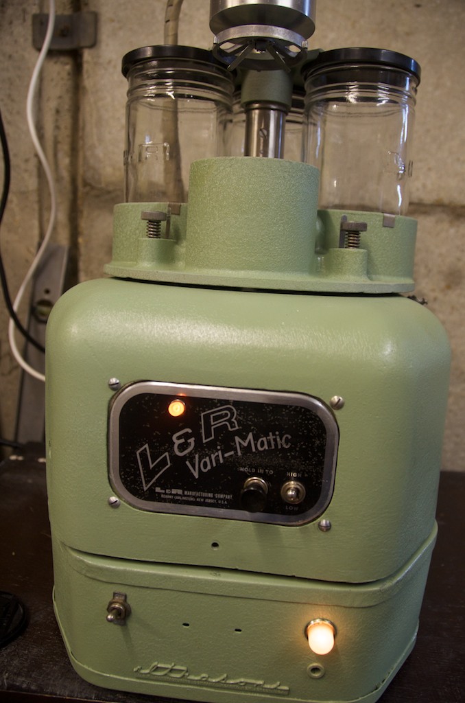

Hello, new member here.  Wondering if anyone here has experience working on L&R watch cleaning machines.
Recently bought a used L&R Varimatic cleaning machine with ultrasonic.  It really had some timing issues when I first tried it out and if I had left the glass jars in it during the test run pretty sure one would have been shattered.  Have sorted the timing out, fairly straight forward once I watched it cycle a few times.  Some cam adjustments.  Bled the hydraulics of air best I could not having the special bleeder cup they use.  So it lifts and lowers properly now.  Trying to determine if the ultrasonic's are working now.  The base unit lights up on the front and hums appropriately and also lights up on the inside.  But no adjustment of the potentiometer on the back seems to make a difference in getting the transducer in the head unit to work.  Basically tried running the unit with the cord for the spinning motor disconnected so I could observe the action of the cleaning head in a still jar of water.  No bubbles or action of any kind.  So I'm guessing it is not working then right?  Suppose the next move is to take the top off of the ultrasonic base and see what's inside.
Does anybody have any opinions on how necessary the ultrasonic part is to the cleaning of movements?  Worst case if I can't get the ultrasonic part active will just the basket spinning back and forth in the cleaning solutions and rinse be adequate for cleaning movements?  Or is the ultrasonic what really does the cleaning?

Had a look for proper ground clockboy to be sure and it is.  Thanks for the heads up.  In fact this machine looks to be somewhat rewired with fairly new micro switches and marretts that certainly are not from the 1950's.
Not sure about the ultrasonic yet.  It's original L&R branded vacuum tube in the base that has loose ends on it, so I'm thinking it's no good.  Was able to find a new old stock (tested) matching GE tube on the bay for a nice price.  So now it's a waiting game.  Pretty sure it's going to be ultrasonic on all three jars though from looking at the switches that trigger it's operation.
As far as cleaning parts being effortless that's what I'm hoping for.
If you want to see if the ultrasonic bath is working drop a few strips of aluminium foil into the water and run it for 5 or 10 minutes. If the u/s is working then the microcavitation will erode the aluminium and the foil will come out raggedy round the edges and maybe even with some holes. You may need to inspect it under a loupe.

And here are some pictures.
The nut in the top centre of this pic is how the lever/cam is rotated to adjust the timing of the jar turret.  The short studs or screw ends extending below the turret is how the timing is adjusted for each of the four stations.  The farther down they are turned the farther they trip a clockwork switch at the front of the machine and the longer it stays at that station.  The double micro switch in the centre of this pic controls the basic on/off of the machine through a cam action on the centre post driving the whole turret.ultrasonic.JPG
This is the ultrasonic base upside down with the bottom off.  The top is solid heavy sheet metal most likely to prevent oil and spilt watch cleaning fluid from affecting the electronics.  The vacuum tube is a 812A which is still available both old stock and new from China.potentiometer.JPG
Now at the back of the ultrasonic unit is a rotating switch I thought was a potentiometer.  And maybe it is but not one that I am used to.  The knob turns the dark brown rod or dowel that pierces the large hollow tube wrap with different gauges of wires.  The turning of this dowel pulls what looks like a piece of iron but could be a magnet back and forth through the tube.  Ingenious to be sure.  The interior of this looks 100% original unlike the cleaning machine which you can see has the much newer micro switches and marretts installed.  The vacuum tube ends are quite loose from the glass tube so I am guessing the tube has leaked and is not functioning correctly even though it still lights up.  I remember as a young lad testing our television tubes at the local hardware store on a machine and riding my bike back and forth between home and the hardware store to test tubes as my father would hand me a new one to test if the prior one had checked out A-OK.  One at a time until the offending culprit was found.  Place them in the appropriate socket and push the test button and hope for a bad readout so I could pick out a new one and end the bicycle trips and watch TV again.  Some that looked horrible were just fine and others that looked brand new were duds.
