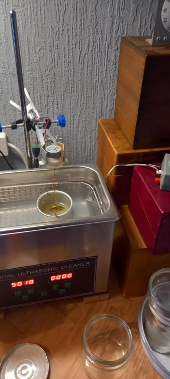

Gotcha H, i do this but rotate the basket slowly and if the movement is particularly dirty hang it from a wire fully assembled and rotate at around 1 revolution per minute.

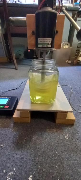

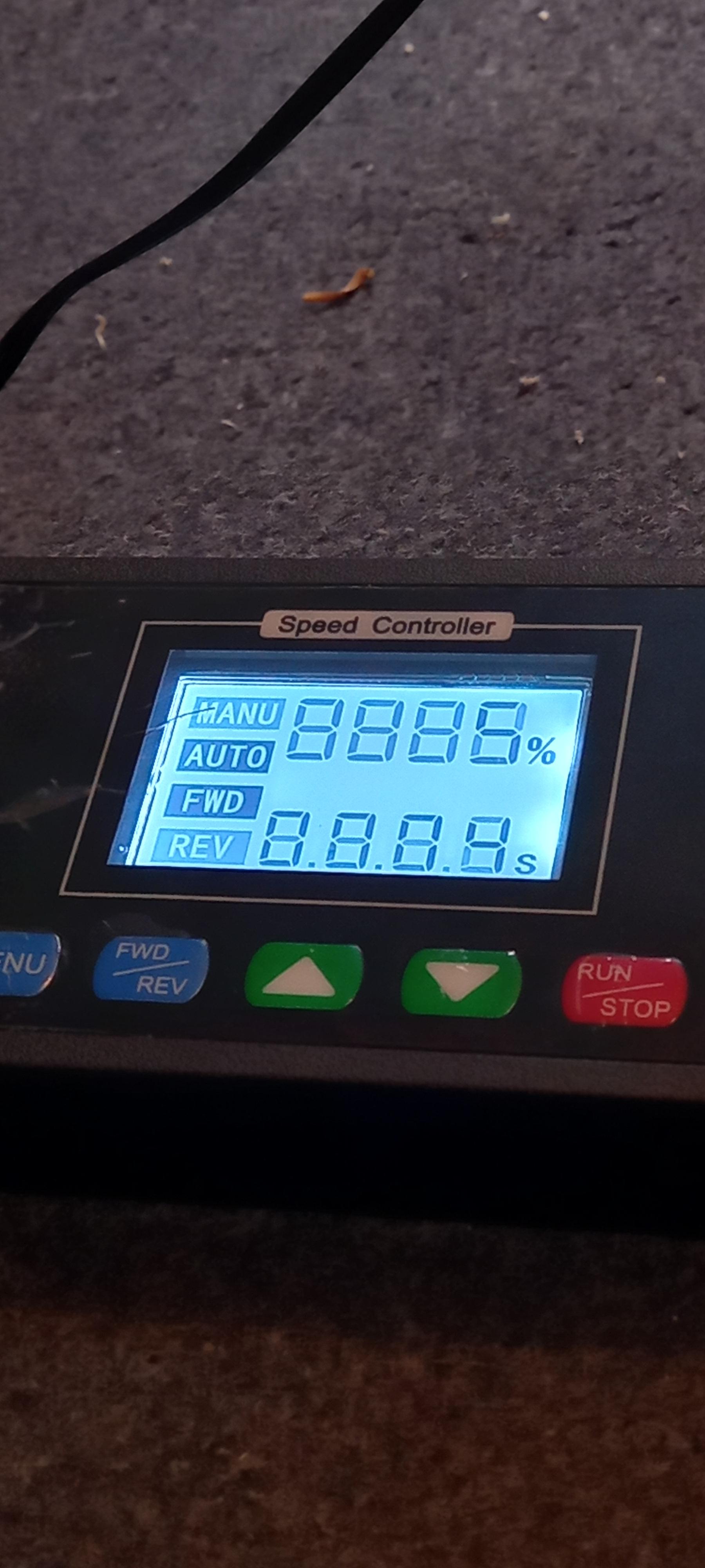

I would love to do it your way, but I have absolutely no clue how to do that. I've seen a few projects on this forum and I'm full of admiration but really don't feel capable of recreating them. If you'd do a walk-through...
The pictures explain the idea. Fully adjustable rotation speed with timed forwards and backwards intervals. Its still in the rough, mainly because i wanted to make sure it works as i want to and to check the heights. The base of the stand will be fully encased in an mdf frame that allows the jars to slide in, lifted up and set down on a pre positioned wooden plate. The drill stand has 80mm of travel through the press....enough to lower and raise baskets into the cleaner. This has cost about 40 quid in total inc. 4 cleaning jars.The stand was a fiver from a boot sale,the motor 13 the programmer 15, power supply for programmer just a quid, 4 jars at 1.50 each and then a few scraps of wood plastic and nuts and bolts....40 quid all in.

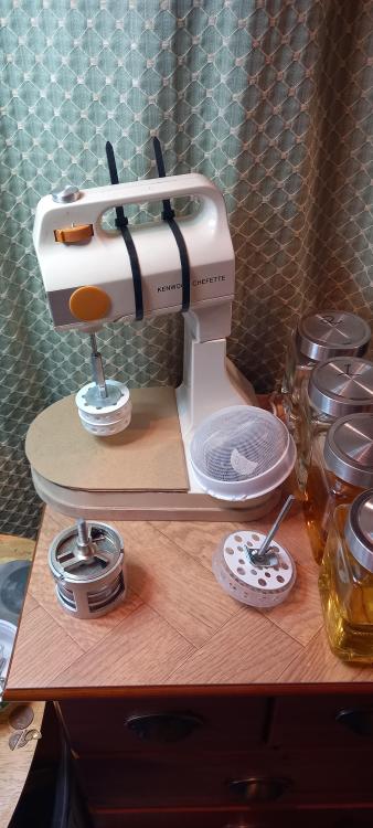

The basket in the photos holds 5 mini mesh baskets. Others carry 7 and a double decker one will manage 8 then a Pearl / Elma copy is used for a more pieced movement...all of them fit or can be adapted to fit with thread reducers the drill press or the kitchen mixer.... and last is another dc motor suspended over the ultrasonic which also runs from the motor programmer, the metal bowl i float in the US and will carry a balance, a hairspring or a pallet fork  This just covers all my bases.
I'm done with cleaning machines now, i think I've built 6 in total......mk 6 works lovely it just needs a little tarting up 🙂
