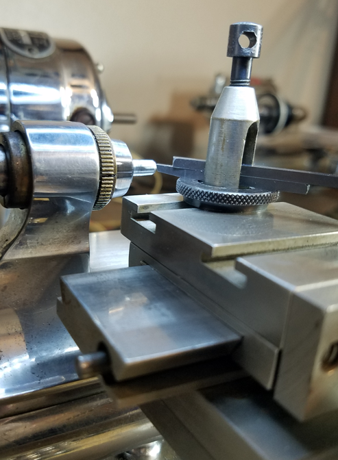

I have this cross slide which I refurbished many months ago, but never really used it.
Now I cannot figure out how to use it.  How to get the graver at the right position vertically?  Some fundamental piece of knowledge is missing in my brain.  As you can see, the graver is too high.  Maybe a different cut on the graver would solve this.  Dunno
Ideas?

That's a rocker tool post. But on the OP's tool post the knurled ring should be the height adjustment, it should be threaded somewhere.
Yes, it is threaded and cranked all the way down.
So when you unscrew it that will raise the tool to the correct vertical position. You should always try to align the cutting tip of the tool to the spindle axis, there are various methods to do that, all explained in the abundance of books and videos on the subject.
Yes, I understand. But I cannot get it low enough to align with the spindle axis. John suggested a holder that has a rocker. I think that would work if I had one,
Which cutter size are you using, and how much down have you ground it?
A common HSS tool size is 3mm square, or 1/8". Even 2mm square is available. These are all good for watchmaking work. You could also check if it's feasible to cut off the last mm from the part that sits on the cross-slide.

All of these types of lathes are 50mm height from the center of spindle to the bed- with the exception of Marshall/Peerless, who went with 2" height; but in this case that would be a help as that gives you an extra 0.8mm of height (not kidding, that can help!). But from memory you do have an actual Marshall slide, so either there is more adjustment in the post but something is sticking, or as above, you need a different one.
Dig though your stuff and see if there's another toolpost somewhere.
I am not familiar with these lathes but in pics I see 3 slides, with the compound in the middle. The slides appear to have some thickness and a space in between, how can all that fit into 50.8mm and still have some distance from the top slide to the spindle? The adjusting knob is maybe just 0.8mm high, do one has to run it clockwise and cut with the bottom of the tool ?!?

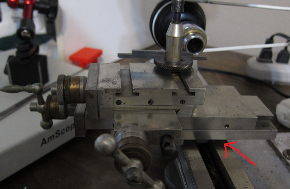

the bottom of the bottom slide should be smack on the bed, what's that gap?
That is the space I was referring to above.
Either that cross table is not the correct to the lathe or the post is the wrong type. The curled nob seems to be at the bottom locking the post in the upper cross-slide.
But looking at the picture you posted there is a possibility you could use that setup anyway.
You could grid a HSS tool so it is in the center of the lathe axis. If it is too high up from the center line it will not cut correctly and get dull faster and if it is to low, under the center line it will risk to catch and get stuck in the material you are cutting instead. The softer the material the greater this risk are.
Just grinding the tool needs a chapter of explaining itself.
How do you have it mounted to the bed? the bottom of the bottom slide should be smack on the bed, what's that gap?
Dammit!!!!!!
This is the only lathe with that plate for mounting the rest.
I feel so dumb.
Tanks to everyone for working my issue so hard!!!!!!
