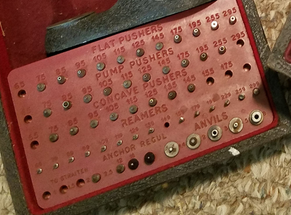

Ok, since today was my introduction to "jewel" issues, I decided to open up the two boxes my Dad left to me.  Identical Seitz jeweling sets.  I think between the two, I have a complete set.  What I need help with is the numbering system (measurement system) so that I can organize all of the components into the right slots.
I found a link to a Seitz brochure/manual on this forum.  It is helpful, but does not answer the measurement question.  I have figured out the reamers because they are stamped.
I think those are measured in hundreds of a mm (Metric millimeters).
As an example I can show the 295, I use a micrometer to measure these exactly.
Here we can se the reading 2.5 + 0.45 = 2.95, in hundreds this make 2.95/ 0.01 = 295.
The types you find in the manual so now you can go on sorting them out.

I suspect you'll probably find that the numbers are in metric. Probably has something to do with the fact this is made by a Swiss company. Typically the Swiss like metric.

There are few versions of this tool.  From what I've gathered, the oldest ones use Ø3mm pushers, which are hard to find.  Current tools and the pushers that are still made are 4mm.
On the newest ones that cap on the head of the stake is threaded on and can be removed.  A smaller cap is placed on the stake and a solid top piece is threaded into internal threads on the micrometer adjusting barrel.  The handle is removed.  This allows the stake to be pushed down by turning the micrometer barrel.  On the tools without this feature the stake and its cap is a single piece and there are no internal threads on the micrometer.
My set is a little different than pictured.  The "reducing ring" on the right end of the 3rd row is missing and there is no space for it.  I don't know what it's for.
Check the reamers for damage and replace any that show damage, they are not that expensive, only a few pounds each from Cousins.
Check the anvils on these sets. The oldest have 3mm anvils and 4mm pushers, and the newest 4mm anvils and 4mm pushers. Cousins have only 4mm anvils(and pushers.
I discovered that the two tools I have ARE different.  The base that holds the stump are two different size holes.  I measured one to be 4mm and the other is smaller--guessing 3mm.
