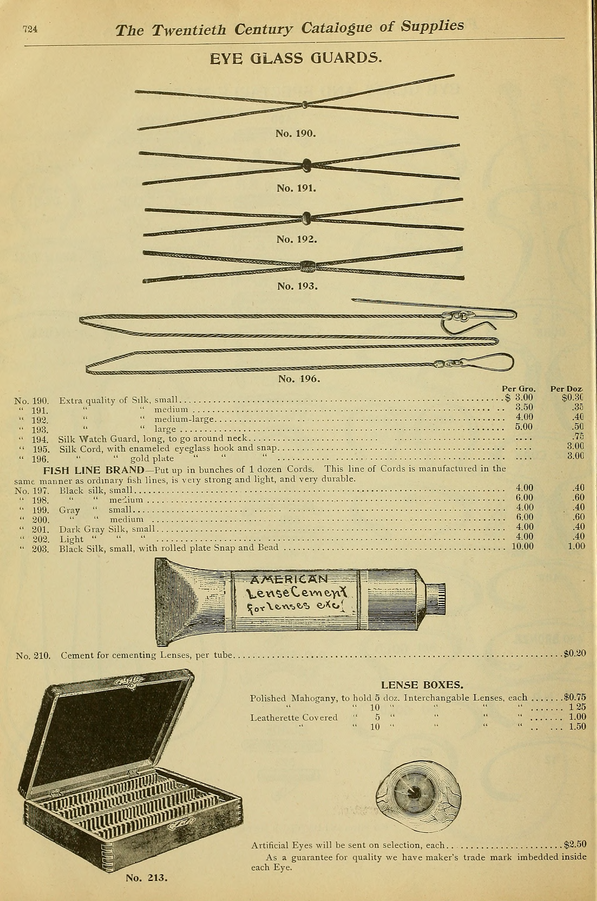

Unfortunately it's a little early but at the link below you'll find a catalogue of 1899 of watch supplies and optical supplies. Conveniently on the crystal page it doesn't say how they're fastened. But in the optics section of course there is optical cement for gluing lenses together which conceivably was used here.
https://archive.org/details/20thcenturycatal00purd
Here's a link that might find interesting.  It was helping with my memory I was trying remember this Canada Balsam. Basically early glue for lenses  and you look at what it is  kinda like a weird form a shellac in a way  very likely what they might've been using.
http:// [Search domain wp.optics.arizona.edu/optomech/wp-content/uploads/sites/53/2016/10/ClementsTutorial1.doc] https://wp.optics.arizona.edu/optomech/wp-content/uploads/sites/53/2016/10/ClementsTutorial1.doc
https://en.wikipedia.org/wiki/Canada_balsam
