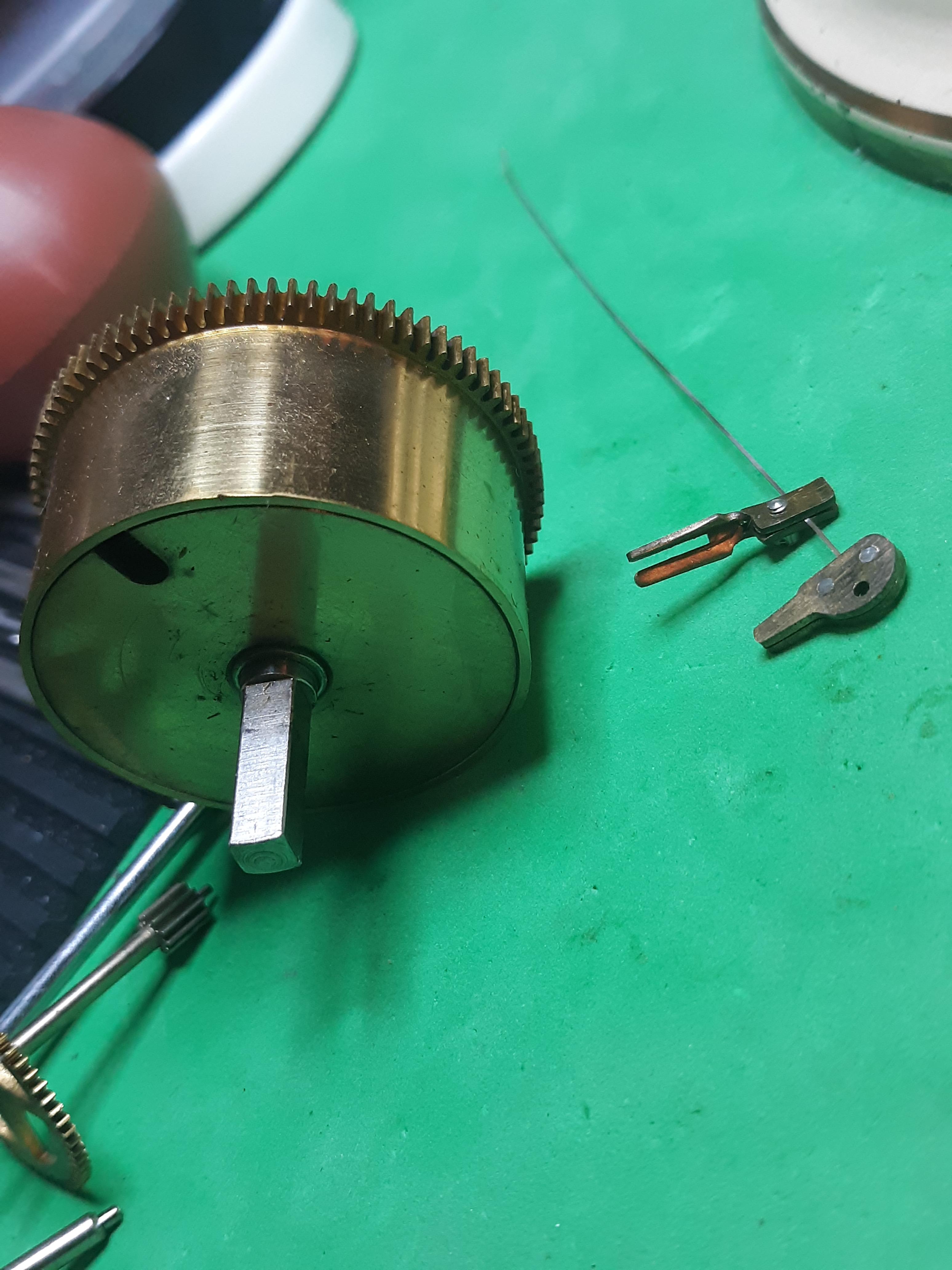

Hard at it on this one. With no mainspring tool, anyone know how to remove this behemoth without losing an eye or a finger? Kundo Anniversary clock circa 1950.
My advice is don't remove it without a mainspring winder, if you do you will distort the spring which will then cause the clock to be a bad time keeper.
There are plenty of videos on you-tube describing how to remove springs without a winder, but you should not be tempted to emulate them pulling the spring out with pliers cause the spring to cone, this will not enable the spring to be replaced without it pushing up onto the barrel cap, causing it to rub on the cap when wound and running, power delivery from the spring will be uneven and regulation or the clock will not be possible, I have had to replace quite a few springs that are coned it can cause excessive wear to both the barrel cap and hole.
If you have not got a mainspring winder you could remove the arbor and soak the barrel and spring in a water free solvent for a few hours dry  with a hair dryer, it will not remove all the gunk this way but it should be cleaner.
If you do decide you may be doing quite a few clocks there are threads on this forum that describe how a mainspring winder can be made quite cheaply or there are commercially available winders, a Ollie Baker, or Webster winder are the best of the bunch for ease of spring removal, I have a Ollie Baker and it is sturdy enough to remove large fusee springs but requires quite a bit of effort, normal springs are easy to remove with one.

Looking at the spring it does not look in a bad condition normally I would recommend always remove the spring BUT that is a strong so leave it in situ. I have a Ollie Baker spring winder and even that sometimes struggles with the big springs.

I should have mentioned that it was wound tight and had to be let down easy, and the suspension spring was snapped. I have a new mainspring enroute. I was worried about it being set. Thoughts?
