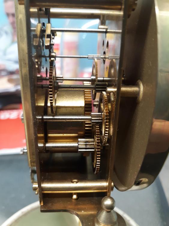

On 12/20/2020 at 2:51 PM, MechanicMike said:
Hi all
I was asked if I could repair this clock. I declined because I know nothing about clocks. I don't even know what kind or style this might be. I searched online with no luck. I'm still curious and thought you guys might be able to help. Here's a pic of the makers mark. I should've taken pics of the dial and glass globe it sat under. It's got a weighted, spinning regulator with 4 small globes attached. It's about 10" in height. It has a manual wind in the back.
 Look familiar to anyone? Thanks

Its a Kieninger  Obergfell  German clock, If you post a picture of the full back plate we will be able to tell you the model. Or purchase Charles Twilliger,s  book  Horolovar 400 day repair guide.  If you are working on these clocks it is a must have as it contains so much information.
As mentioned by OH they are a world apart from a carriage clock, for instance they must be perfectly level to function the almost total lack of friction is what allows them to run for 400 days on one wind.

I have one these and it looks like I'll be using it again here by what you guys are telling me. time to sit down and get it in beat again. Just wondering why the thing was running great for months then stops? do they do this?
It can happen Mike  they are more tempremental than women.  Where old H has indicated oil there should be a minimum of space just enough so as the fork does not bind on the shaft at the end of its travel.  Have a beer take a deep breath get the blood pressure down and then start again.  good luck.

A tiny drop of oil at the tip of the blue arrows
yes thats the first thing I asked the owner-was it bumped? moved or tinkered with? did the dog move or knock it off the shelf? the owner had replied no to all. I'll re-apply a tiny dab of oil on the fork. and start over again.
