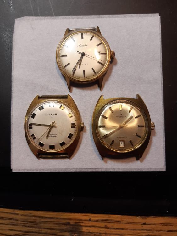

I was interested in the Mauthe watch on the top but had to buy it with the two others.
Fortunately I got them cheap at the auction and the final price divided with three makes them
End up in the 404 club. Never the less an interesting bunch to work on at Sundays.
Mauthe was a German clock manufacturer who went into the watch business around 1945. I earlier didn’t have in my watch collection but now it ends up in the reference group.
The Ankra 70 also is a German watch. Ankra was  a sales cooperative of German watchmakers founded in Leipzig in 1925.
The third is an Mondia Automatic, a swiss brand from the La Chaux-de-Fonds, they later became bought up and formed the Movado-Zenith-Mondia umbrella in the late 60’s.
Two of them are snapbacks, there has been an attempt to break into the Mondia with the help of a pair of garden scissors.
Inside the Mauthe one finds the F.Mauthe Cal. 612. A quite interesting piece equipped with the Mauthe Super-Contrachoc.
The Ankra reviled a French Lorsa P72, quite a surprise.
The Mondia didn’t put out any surprises, the workhorse AS1903 is looking dead at me.
A dip in the ultrasonic bath, some lubrication, a new crystal and a pimpt up bracelet and it’s back to it’s 60’s bling bling shape. Not bad for a few dollars more, even Clint Eastwood would agree 😉

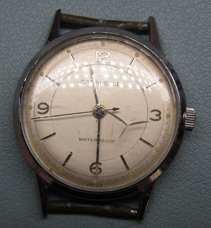

Here is a Caravelle I got for 5 bucks.
I serviced it and it is sitting on the bench waiting for casing.
In the mean time, here is the movement: Caravelle 2SO (which some believe is a Citizen movement--the dial says "Japan").
Will post the final result later.

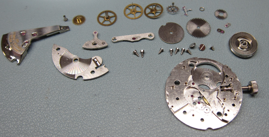

I have a habit to click away during the servicing process. So, here we go a picture of the Contrachock system.
