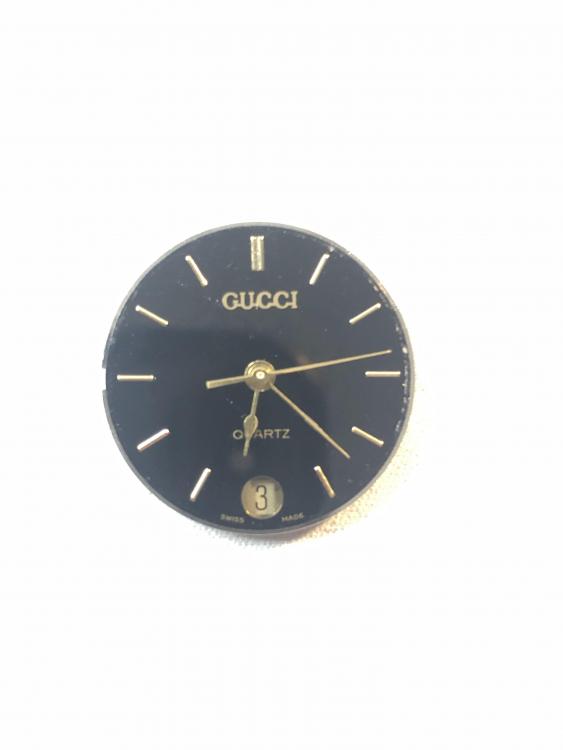

The movement appeared to be working fine when I was able to get the battery to function (before the negative contact became disconnected). Here is a photo of the dial.

From the image it looks like the date indicator may be white. I can't tell for sure. As was mentioned, if you want to change it over it shouldn't be a terrible job. Probably just a few screws with retainers. I will say that with the color of the hour markers, etc., on your watch, the gold one might actually look better. There is also the issue that the date ring needs to have the numbers at proper orientation for the 6 o'clock location. I'll look at the auction to see how the date is situated and will add to this comment.
Looks like a winner. 3 hands and proper date ring. Good luck.
Just bought the movement, excited for it to arrive in about a week. I will check back in then :)
