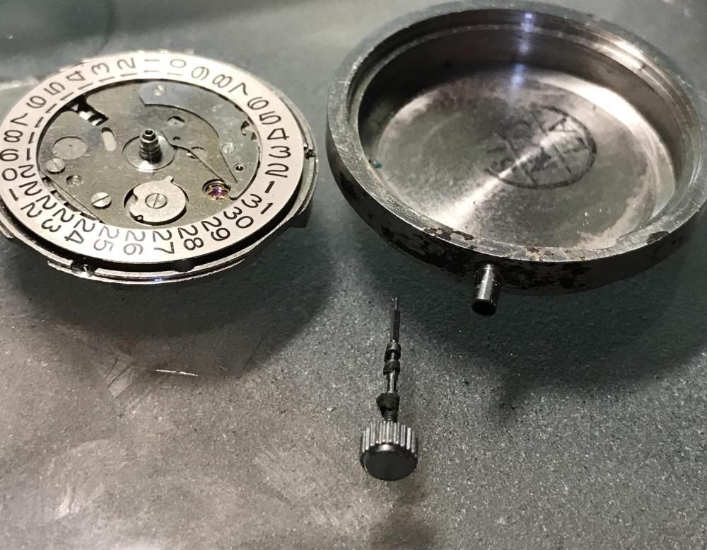

I have a Seiko 7006 5000 that has the odd case—TV dial shaped. I know there is a lever located in the notch at the 2:00 position but I've tried for two days to get the stem out with no luck. Is the dial on this watch screwed on? I was about to remove the hands and lift the dial off, but I suspect it is screwed on. The only alternative left is to cut the stem and replace it. I would really like to keep the stem intact if possible. Any suggestions would be greatly appreciated.

Are you pressing on the lever from the dial side? If so that’s your problem. There is a hole that you can stick a needle or pointed object into from the back of the movement. The dial is held on by screws which can be located around the edges of the movement you will know them when you see them because you will see the dial feet right next to them. If you can’t get stem out then you will have to dismantle the keyless works and the hands and dial must come off in order to do that. And that will 100% need to be done if the keys are locked, can you still click the the stem in and out? And if you do get the stem loose make sure the stem is clicked in before you pull it out and do so gently so the keys don’t lock on you

You can access the dial screws from the bridge side. Turn the circled screw 180 degrees until small slot is next too dial pin.
Thanks, but this is the Seiko that comes out with the case back attached. The face of the case lifts off leaving the movement incased in the case back. There is a tiny hole in the dial side at the 2:00 position that allows you to take a tiny pick or screw driver to depress the lever. This is a very odd Seiko and many have not had experience with these watches.

The only way I see is to try to carefully rise the movement over the edge and see if it's possible to access and turn the eccentrics. Be carefull not to take off the dial feet, it's easier to find a new stem/crown than soldering the feet again.

Thanks to both of you. You two know of the actual watch I am having problems with. It appears the lever is extended when the crown is pulled out, but under heavy loupe I do not see the lever—probably a problem left by the previous hands in the movement.
I will no doubt make more work for myself if I break the dial feet, so on to the cutting tool and the removal of the stem. I will show a picture once off...
Regards.
Not the outcome I was looking for. While trying to pry the dial I broke a foot, but I was able to get to the lever. The red arrow points to the lever that should be pressed down through the notch at the 2:00 position on the dial. That lever then pushes UP on the lever pointed to by the blue arrow. However, the red arrow lever was/is frozen which made it impossible to remove the stem. After I got the dial off I was able to pry UP on the blue arrow lever and remove the stem.
If someone in the future needs to remove a stem I suggest bending a small screw driver blade. Pull the stem all the way out which extends the blue arrow lever. Insert the screw driver toward the stem day/date window and attempt to pry up on the blue arrow lever. None of these parts are visible via loupe through the notch.
