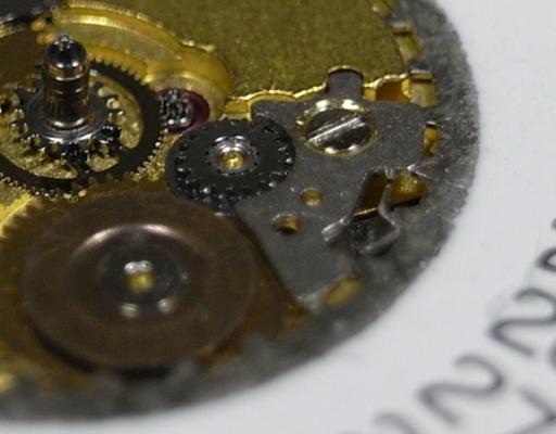

Remove the two Date Wheel Keepers.
I always start with the one holding the Date Jumper Spring in place.
Sometimes the Date Jumper Spring can ping out of place, so be careful when removing the keeper plate above it.
Here is a reference photo in case it moves before you see how it's properly seated.
Next remove the Keepers and Date Wheel.

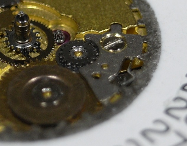

The Rotor should be cleaned by use of Rodico.  As you can see from the picture below, it's surprising the dirt and old oil this will remove ... and it is sufficient cleaning for the Rotor.

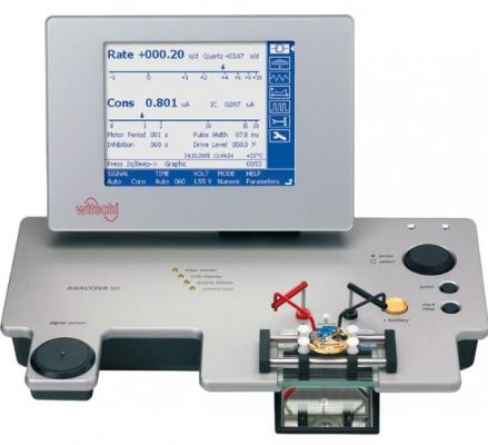

Thanks for the kind replies my friends.
Bob, yes I have a way to troubleshoot the electronics of the quartz movement; but not at home :(
Even cheap ones are around AU$1000.00, and I'd be dubious of there reliability.
At present, this is the unit I am using made by Witschi, and it has trouble sensing some of the new Chinese movements with the probes; and you have to place a battery in them put them on the mic block to the far left.  But even this old model run at around AU$2700.00
The really good one is this model.  The Witschi Analyzer Q1
But at over AU$6000.00 for one ... FOR GET IT!
If anyone has FIRST HAND experience with a cheaper alternative, that works well and reads reliably both Swiss and Asian movements, I'd be appreciate them chiming in, as I would like to get one for home.

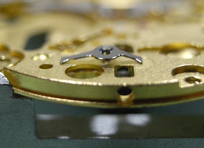

Firstly install the Setting Lever Jumper and the Double Corrector Operating Lever.
D5 on the Corrector Lever Pivot
9501 on the Setting Jumper

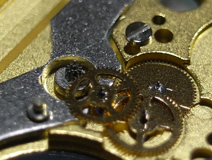

Next install the Rotor, and you'll find due to it being magnetized, it will stick to the Stator.  DO NOT try and locate it in it's jewel, as it will just pop out and stick to the Stator again, and this can be very frustrating ... but I have a little trick that will cure this :)
Place one of the screws on the opposite side of the Main Plate, behind where the Rotor is located, and you'll see it will be attracted to the Rotor (as seen below).  This little screw will pull the Rotor downwards and stop it being pulled over by the Stator, so you now can locate it in it's jewel.
Don't forget to remove and demagnetize the screw once you've completed installing the gear train.

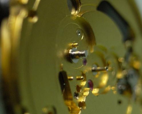

There is a LOT of discussion on oiling quartz gear trains.  The ETA Service Manual says to use Moebius 9014 on this particular movement; but I prefer Moebius Quartz Oil, as it can be used on both metal and plastic gears without concern ... why have 2 oils when 1 will suffice for both applications.
Others say, don't oil the gear train at all, as it just adds load to the movement and makes it draw more current.  Personally, I'd rather change a battery a little earlier than change out a worn out movement ... you choose which is cheaper.
When oiling any quartz gear train, we only apply about half of what you'd use on a mechanical movement ... it's called Ghost Oiling.  That being said, ghost oil the jewel for the Third Wheel with Quartz Oil as shown below.

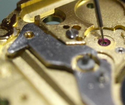

Ghost Oil the upper part of the Second Wheel with Quartz Oil as shown below
Fit the Gear Train into the Main Plate.
Place the Gear Train Bridge over the wheels, locate the pivots carefully until all are freely spinning, and tighten down the bridge.
Remember once the screw makes contact with the bridge, STOP, and recheck the free spinning of the train before completely tightening the screw.

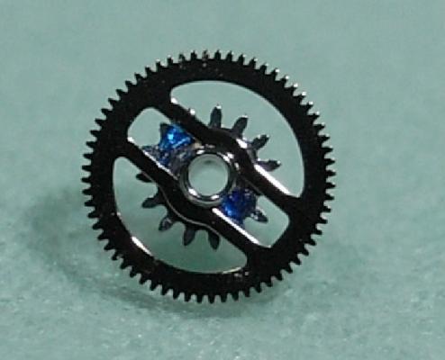

Next is lubricating the Cannon Pinion.  This is one step that MUST be done correctly, otherwise too much friction will occur and you'll damage the Setting Wheel in short order.
9501 Canon Pinion fiction points
Place the Canon Pinion and then the Minute Wheel
D5 Minute Wheel pivot
D5 Ghost Oil the Canon Pinion Tube

The rest should be demagnetized prior to cleaning to avoid any metal particles in your cleaning solution from sticking to your parts.  When cleaning I also including the Insulator Block, and Battery Insulator in the basket, normal watch cleaning solutions do not harm these items and it is essential they are completely clean to provide the best insulation possible.

On 1/25/2015 at 1:13 AM, bobm12 said:
I've read about those and they are a dream that might never happen. I was just thinking about regular multi-meter (stone age maybe?) type of troubleshooting. So far I test only continuity on coils but I'm afraid to use other functions on the meter for different parts. I think I could burn something with the current generated by the tool. For example, impedance and how to measure it safely on coils...and then the actual circuit. Lots and lots of questions yet! Nice to have a tutorial of someone doing it.
By the way, you said you demagnetized certain parts. How did you do that? Did you hold them down on something and then did the trick with the demagnetizer? Everytime there are lots of smaller parts on the loose they bounce around in my demagnetizer so the purpose of it is lost...
In any case, many questions and all thanks to your great tutorial...without it, they wouldn't have surfaced! Way to go Lawson and long way for me to learn this side of the trade!
