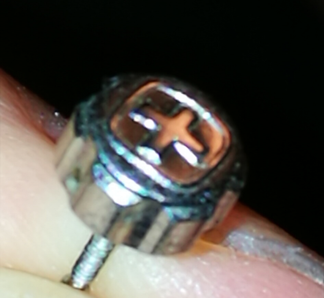

Is this a rubber 'O' ring in here? IMG_20200323_144424.thumb.jpg.09114015dcf2cfc1c650dcf4ec17eca3.jpg
Not too sure how to approach replacing this....
Or do I just hit it with my chequebook?

That is almost impossible. Can be done by removing the thin washer. But it's hard to put it back again. Can maybe be done like this. https://adventuresinamateurwatchfettling.com/2015/10/12/crown-revival-seiko-6105-and-62mas-crown-gasket-replacement/
This is how I do them, except I don't try to save the cap, I just get it out and make a new one. But that fellow's technique is really good!

Ahhhhh....... Umm the rubber does have some give left in it.... I think I may just grease it & leave it there... Shame, I was getting all keen...
Thanks Chaps !

I've always managed to remove these without breaking anything. I use a dental pick, it doesn't have the ideal shape I have found anything better so far.
50 minutes ago, oldhippy said:
Just replace the complete button. They are called water proof buttons.
That's OK with cheapies where originality is not important. But in most cases actually in which the presence of a logo, or the material, size and shape make so that a generic replacement is out of question.
Its a Wenger, they are quiet reticent to supply spares to mortals such as myself.... IMG_20200324_233921.thumb.png.64b9fd43794202468e611ae583f327c9.png
