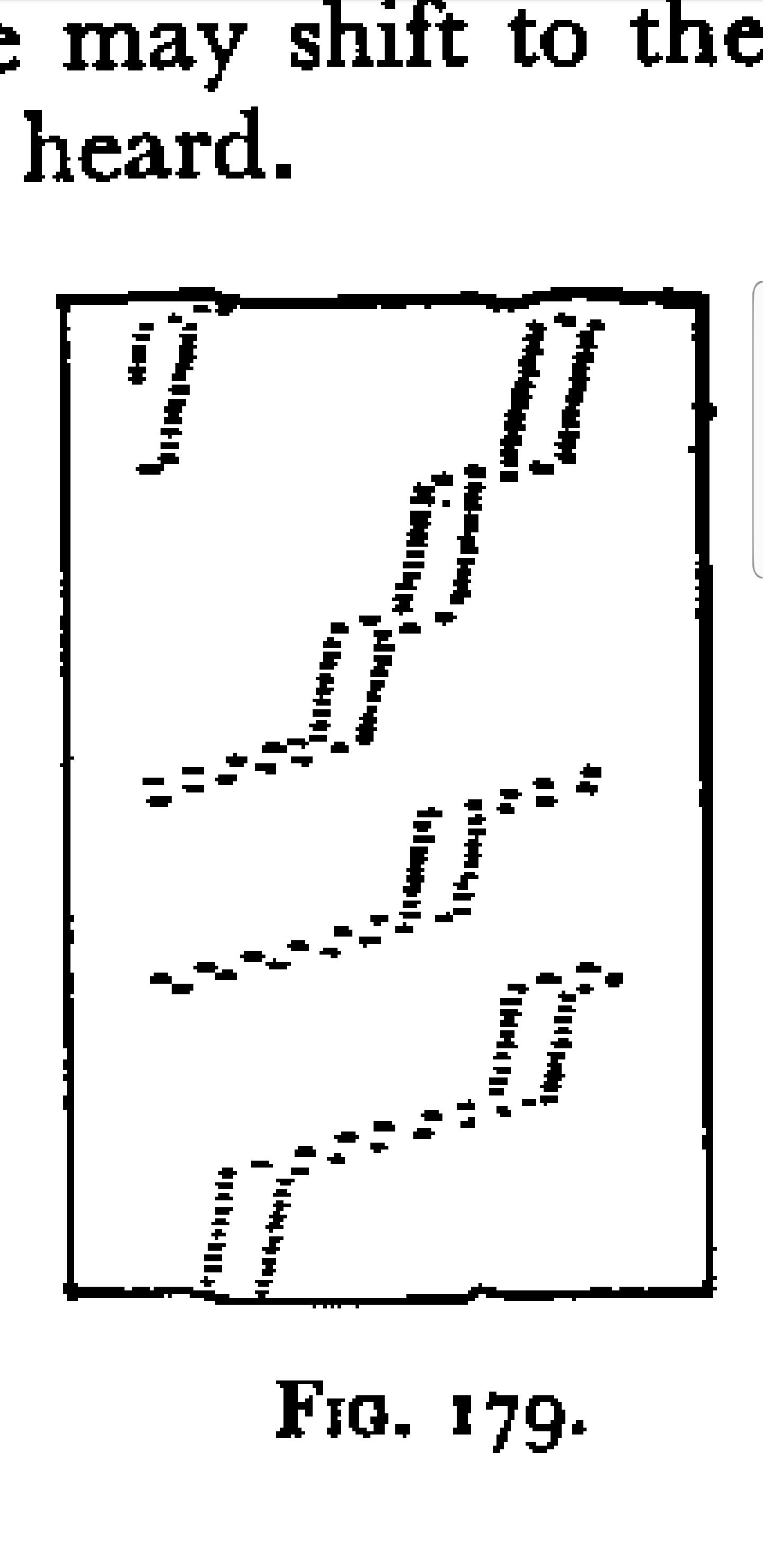

Have you ruled out knocking? What does the trace look like on the timing machine? Amplitude?

Not much to say really. It's a symptom of excessive amplitude, the balance wheel swinging so wide it makes a complete revolution and the impulse jewel crashes into the opposite fork horn and bouncing back. This will cause the watch to periodically gain considerably. Use a weaker mainspring and/or heavier oil to remedy. Trace on timing machine would look something similar to this:

Thank you. I don,t think I have ever dealt with such a case, but then I hardly replace a mainspring and am pretty sure oils here are more of massey ferguson extract. :)
Best
The newest 7002 is over 20 years old and most you run into are pretty neglected. The several I’ve worked on can achieve pretty good amp, usually in the mid to high 200s but nothing much more, so I’d be inclined to rule out overbanking. Timegrapher traces would be helpful though
