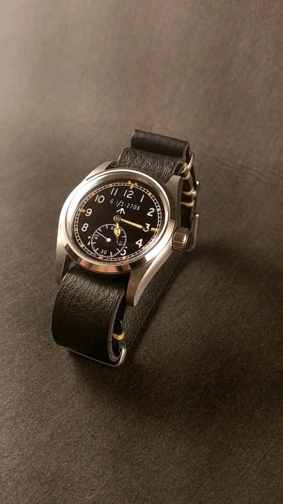

Just finished a vintage build with correct working seconds at the six position. Hard to find a good reissue so I made my own with a aftermarket case and a dial made by me from scratch. logo is also my logo. Looks very professional maybe I could get some opinions from you guys. I have 25 more dials with different designs from single sub seconds to 2 and 3 eye chronographs. Its hard to find the cases I want. I guess I will settle with aftermarket cases for now and modify them.

Nice work ! I have always loved the "dirty dozen" type watch , I have been considering doing such a thing .I  have several several elgin sportsmans which use the elgin 723 which I believe is a jeambrun ps32, a half way decent caliber. Kudos on your creation.
Printing white on black is a bit tricky, how did you manage that,  or is this actually black print on a white substrate?
I did find a source of white laser toner at one stage, but I haven't had a chance to experiment with it.
Another possibility would be screen printing, but the issue with that would be resolution. Screen printing is a bit limited in that regard.
I also looked at using a pen plotter with white ink, but also haven't had a chance to try that out.
Either way its a pretty slick build. The case is also impressive. I have a bunch of HMT steel cases in a similar style. The problem with them is that there is no consistent source, and they don't have a display back.

 A true military  watch would  not have a display  back.
A fair point, and it could also be argued that HMT did produce military watches, however anything I produce would be a homage, so I guess I can take a few liberties.

Hmt cases are excellent..you could  build  yourself  something  nice. But a sub dial  watch might be pretty  tough with a standard hmt movement. You would  have to fit something  else
An a11 dial wouldn't  be too tough  and would  probably  look right in an HMT case

Nice job, I also have been looking to build one and have bought a hmt  36mm case and fits a Chinese sub dial movement. I have done some printing and found better results with a white background with black print for numbers and markings and when finished invert the colours so black becomes white and white becomes black, copy layers twice , flatten and sharpen to the max without going too far as to distort image, then print in black and white in high definition text.  It took a while to get the thickness of the rail tracks but it is achievable

Generally dials are metal, with some form of printing or transfer on them. There are many different methods of producing dials, but I can't say I have ever seen a paper one, so I wouldn't have assumed they were.
How did you produce those results? Are you using laser toner transfer, water slide decals? Curious minds want to know.
