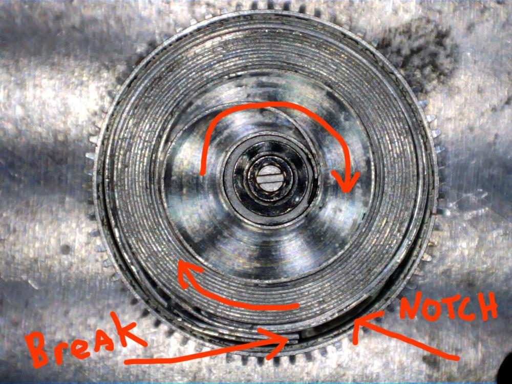

I have a Citizen 33J cal 5204 which is driving me nuts trying to get decent amplitude.
I'm pretty sure it's the mainspring slipping in the barrel. This is the procedure from the service manual -
Where it says 'Check the number of rotations by re-winding the mainspring' - does that mean letting down the mainspring ?
As the arbor has a slit in the top, it's easy to watch it. If I wind it about 10 rotations, then let the spring down, the arbor only turns about 1 revolution :huh:
I use Moebius 8217 on the barrel wall. I thought I might have used too much, so cleaned it and put very little on, and fitted a new mainspring.
Any ideas ?
Thanks
(the pic is the old spring before cleaning !)

something doesnt look right on the outer most coil. did you use a mainspring winder to install the MS? re-winding does mean letting it down i would think but how are you unwinding it? your not just simply releasing the click are you.
ok this is what i suggest: take barrel out and remove lid. turn the arbor with a driver and watch the coils wind up, while keeping barrel between your fingers on a flat surface. you will see if its slipping right away.
NOW i think this IS your issue: if the mainspring starts to pop out as you are winding then thats most likely due to an improper install, and when the lid is on the coils are rubbing up against the barrel lid adding friction and resistance to the MS causing loss in the power which equals Low amplitude.
check that and get back to us

I agree the spring doesn't look right in that pic. There were signs that it had been rubbing on the barrel lid.  One reason I changed it was the height was 1.1 mm, whereas the original spec shows 1.2 mm
I do use a spring winder, though as these wind the 'wrong way' I have to wind it in to the next smaller winder, then transfer it to the correct size to get it the right way round.
I unwind it by releasing the click whilst controlling the crown in my fingers.
I agree it's a good idea to remove the lid and watch it wind, though the slot in the arbor isn't deep enough for a screwdriver, so I'll have to try and use a pin vice.

wind the wrong way? then you just wind the spring into the winder in the opposite side going clockwise or counter clockwise. and transferring it to correct size do you mean going from smaller winder to larger winder?  when you say size do you mean size of the arbor on the winder so the hole end is shaped right? if thats the case then that should not dictate wether you use a smaller winder. you should select your winder based on the size of the barrel not the arbor. most mainsprings dont have the correct shape at the end to fit the arbor in the watch, so you have to shape it. you can use a pair of wire beading pliers to shape the hole end once its in the barrel. some of these pliers are made of nylon so you dont have to worry about marking or burring the mainspring or barrel.
also if there was a 1.1 in there before and you replaced it with a 1.2 now your seeing signs of rubbing then i would say there was a reason it may have had the 1.1. and you should replace it with the same.
LAST NOTE: SEE MY PIC
looking at the picture it looks as if the notch on the wall of the barrel is at the bottom and the break is against it coming from its left side, and then looking at the hole end its in the clockwise direction. if iam right on my observation then the MS has been installed in the wrong direction, hence the slipping. the MS should wind in the opposite direction of the notch on the barrel wall. as you can see with may arrows that there is nothing stopping the MS from sliding against the wall of the barrel.
I don't think the spring is broken, that's just the bridle overlapping itself and is normal.
If you try to wind a spring in a barrel with the lid off, the coils WILL jump out. It's not a sign of a deformed spring. And it's a common method to get "backwards" springs in to use a winder one size too small, and transfer to the proper winder then barrel. And if original is 1.2mm high, it's pretty certain that's the correct height. Many barrels will show signs of rubbing after years of use, see above about coils jumping out. The lid and barrel bottom keep them in, they rub.
As to the slipping issue, it is probably a combination of a worn barrel wall and incorrect grease. The 8217 is from the old Glissalube line, which changed designation to fit the numerical system Moebius uses. The 8213 (old Glissalube A) is strong braking, recommended for brass barrels. The 8212 (old Glissalube B ) is weak braking and recommened for aluminum barrels. The 8217 (old Glissalube 20) is considered "normal" braking but Moebius lists it as "soft" for all barrels.
Some auto barrels have notches around the wall, some are smooth. Both can get worn to where they slip too easily. If it's your own watch, a rub around the inside with rough emery paper may do the trick. Going to a more "braky" grease could do it too. Maybe both, maybe you just need a new barrel and the more braky grease.

The barrel wall doesn't look too bad, a bit worn and smooth. I'll try to get a replacement barrel and some 8213.

As @nickelsilver pointed out, the barrel has worn through the nickel plating to brass.
I therefore plan to change the barrel, when I can find a replacement - there are some NOS on ebay but I don't know the part number. Anyone got a reference to Citizen parts lists? I have the technical/service manuals but can't find any parts list.
With a replacement barre l+ new spring + 8213, I should hopefully get decent amplitude !

I'm pinning my hopes on it being the mainspring. I've examined every jewel/pivot under the microscope - the gear train runs beautifully, (tried all individually and together) as does the new balance (nothing touching). The pallet/jewels look good. Had it stripped down about 6 times trying to find the cause !
Currently showing just 215 deg.
Out of interest I looked up the coefficient of frictions (sliding) for brass and nickel :
nickel to mild steel is 0.64,  brass to mild steel  0.44  (couldn't find numbers for spring steel)
So when the nickel wears through, the friction drops about 30%
