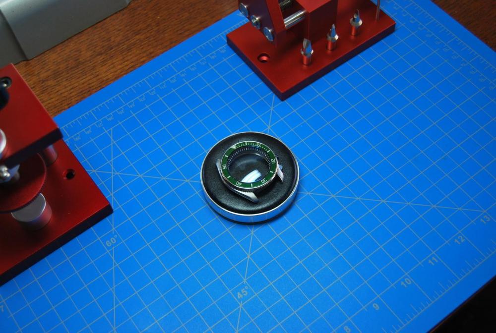

Finally, the parts have just about dribbled in. I'm awaiting only the replacement dial and it's on US soil, inbound to me from the port of Los Angeles. It might reach me by Friday. So far, the case has been stripped, cleaned and polished. I've replaced the stock bezel with an aftermarket coin edge stainless steel model. After installing a new bezel gasket and a green insert, it snapped into place easily with a press.
Next, I replaced the original flat mineral glass with a double domed, blue AR coated sapphire version. I have the replacement movement (Seiko 7S36, 23J) ready to go with the exception of installing the hands. They finally arrived from Australia after being in transit 39 days. I'll show them after the new dial is fitted.

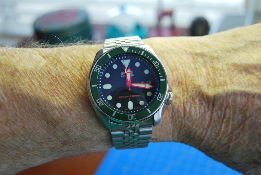

The project finally came to fruition today. The new dial arrived and I assembled the old girl. At first, I couldn't get the movement to align with the chapter ring properly. After further investigation, I found that I had somehow let the chapter ring slip when installing the new crystal. Out came the crystal again, correctly aligned the chapter ring with the keeper in the milled slot, then reassembled it all. Now, everything's good to go.
Old: 7S26 21J mechanical auto wind movement, flat mineral glass crystal, factory supplied hands. Literally, any stock SKX007 will show you what I began with.
New: 7S36 23J mechanical auto wind movement, double domed blue AG coated crystal, custom coin edge 316L bezel, green insert, new crown.
I've installed the original Jubilee bracelet from Seiko that the watch has always worn. I've ordered new fat spring bars as the old ones are a bit dodgy. I won't wear the watch until I have those in hand and change them out. Total cost of parts = $92. Labor = $0. Fun involved with project = priceless! A big old Texas "Thank you pardner" goes out to Mark without whose videos and encouragement this would have never happened.
