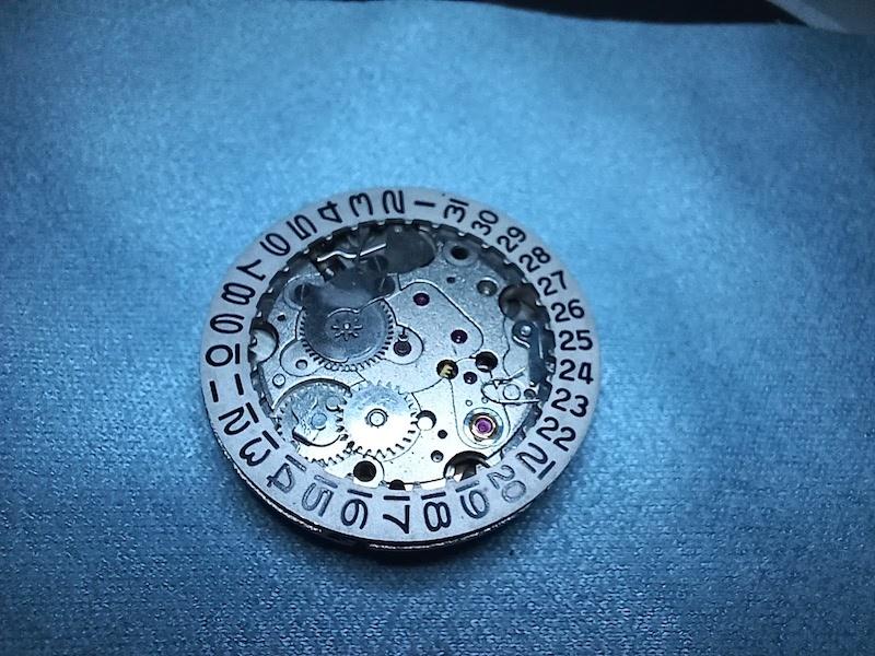

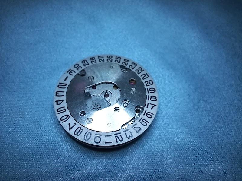

  3. Hello All, Since my last post about an Omega and a Seiko, I have fallen deeper and deeper into the buying vintage watches and cleaning the putting-back-together hole. So I picked up this guy from one of the auction sites for about $10 I stripped everything down, cleaned everything, and tried to put it all back together. Seems everything went well I am however stuck at the calendar wheel and spring. Seems the last guy that came in here lost the spring and made one of those guitar string type spring. I know that it works as I tested it before I took things apart. Only thing is it does not sit flush and its a juggling affair to get the spring to sit pushing on the calendar lever sitting just so the date wheel without flying into space. Then only I can put this plate on. As far as I can tell, the plate is what is holding this precarious spring lever date wheel sandwich all in its place. I can take it apart, I am amazed at the previous guy to get it all in just so. Can I get any advice on how I can get this done? The options I looked at are 01. Place the spring and lever, have the lever away from the spring, put the plate on, and try to slide the date wheel in. *** Nope does not work that way 02. Try to have the date wheel a little away, place the lever away from the spring and try to adjust after one of the screws are placed. *** Nope The spring does not like to stay in place 03. Have not tried this but I am thinking of super gluing or somehow fixing the spring down. Screw the plate on and then shove the lever into place *** What do you think? 04. Track down the actual spring and get either a donor movement or part. *** seems like an expensive way to repair something that was about $10 05. Black out all the dates and call it a design and also call it a day *** translation Giving up. I would really appreciate the opportunity to learn how the last guy actually did it.
