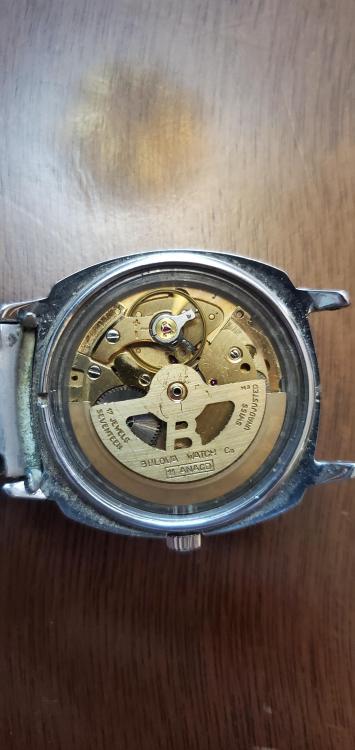

  2. I bought a vintage bulova sea king automatic at a antique mall for 80 dollars and I discovered the reason for its lower cost. It appears that it was someone's project watch that they sold. It has a 11 Anacd movement and the rotor is stuck. It can move but it grinds against the metal underneath it. The middle portion of the rotor(with the engraving) is loose and moves independently of the rest of the rotor. I have no clue how to remove the rotor as there are no screws on it. Is this a deeper problem than just the rotor or can I fix/ replace the rotor?
