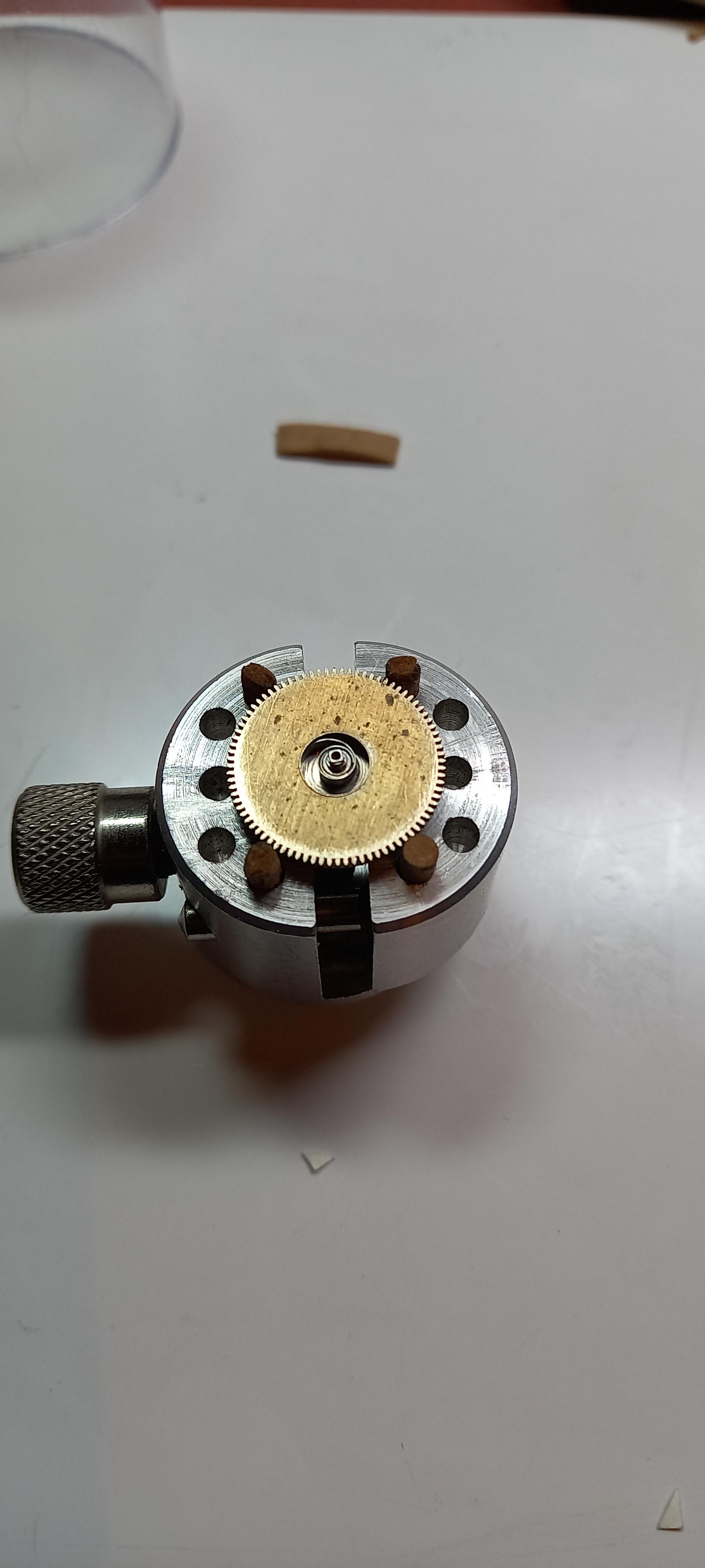

  4. Trying out my idea for sandwiching a barrel within another barrel to stop the mainspring from popping out . These little vices are great for holding round parts , pegwood inserts for gripping. Just wondering that i have enough barrels , as long as dont make to many mistakes enlarging the hole on the lid I think I'll be ok. A thought occured to me while i was making the barrel hole larger. I've thought about this a lot when working with metal. What precautions do folk here take with their eyes, besides the obvious of glasses visors etc. I've noticed metal filings can become engrained into the skin of fingers when not wearing gloves. Anyone had any mishaps, I've pulled bits of steel from my eyes with magnets many years ago at work. Magnets only draw on ferromagnetic metal though, what about brass or other ? Works a treat, the arbor backed out of mainspring and lifted out...no hassle and no crawling around on the floor looking for flung pieces. The paper traps the small barrel inside the big barrel so it doesn't move around when turning the arbor out. Could make the hole a little bigger if need be, but if you have nightmares about losing your barrel arbor then this could be your answer.

  9. I have the whole set of barrel arbor holders. This happens when you live in Watch Land and frequent flea markets (I got a lot of other cool sh!t too). I use then rarely, but appreciate them when I do. Well worn stout nickel tweezers are my go-to. And I do occasionally search the floor, and not just for barrel arbors. The purpose made tools work well, but good pinvices well employed can work as well.

  27. That defeats the objective of using the arbor vice. Once the mainspring is removed from the barrel, the arbor is easily taken out. Its the leap of the mainspring from the barrel as the last two or so coils are about to be removed. If the arbor is still attached then , thats when you're going to be on your knees searching for it and probably the barrel as well. Best to get the arbor out safe and sound before taking out the mainspring . Unless the idea is to put the barrel assembly minus the lid upside-down over a big hole on a staking block and then push out the arbor. That idea seems to have problems attached to it, lining up the arbor and stake hole and not being able to see to work the hook free. If an idea at all then cover the barrel with the mainspring facing up or put the barrel into a larger barrel with an enlarged hole in its lid.
