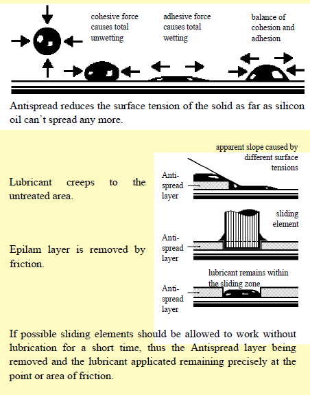

  7. I found a PDF that might help answer a few questions. entire document is a really nice thing to read but I snipped out the important image of showing what epilam is supposed to do and how it's supposed to work. Antispread Epilimisation Epilame.pdf

  9. Yes the entire escape wheel, the issue is when the contact points are not lubricated as in the case of pallet fork pivots. I guess it doesn't matter where the epilame lays, the problem is when is epilame between two dry points of contact. And this may all just apply to a type of epilame at a particular point in time. This happens a lot a name that is applied to many different things, that dont all fully relate.

  10. But it's OK on the plate side jewels...? Taking a step back to look at the forrest (for the trees), the point of this stuff is to keep the lubrication where it's intended. If you don't use too much oil, surface tension and capillary action do a fine job of this, right? Did for a long time anyway. At some point, I suppose, the oils could migrate away, but how long does that take? If a service interval on your typical watch is 2 years (Omega's Co-Axial movements get a bit longer), and one assumes this is due to breakdown/oxidation of the oils, are you gaining anything? I am definitely no Epliame or Fix-o-drop expert, but it seems to me this is one of those deals where you're chasing the last 1% of perfection in the idiom I can't quite remember where 99% of your time is spent chasing the last 1% of perfection. By all means, chase it, but I wouldn't worry about it too much until you've achieved the 99th percentile. Just a little perspective...

  19. Yes, like Never said, it's no issue on parts that get lubricated. Capillary attraction keeps the oil at the pivot-jewel interface.
