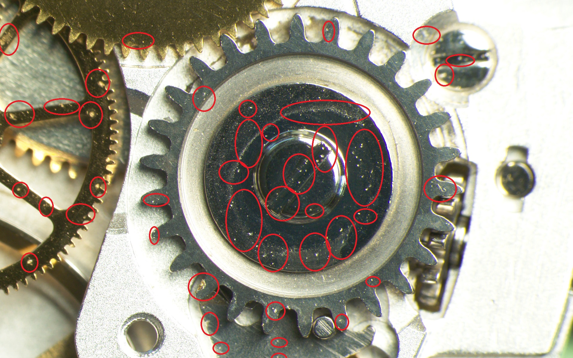

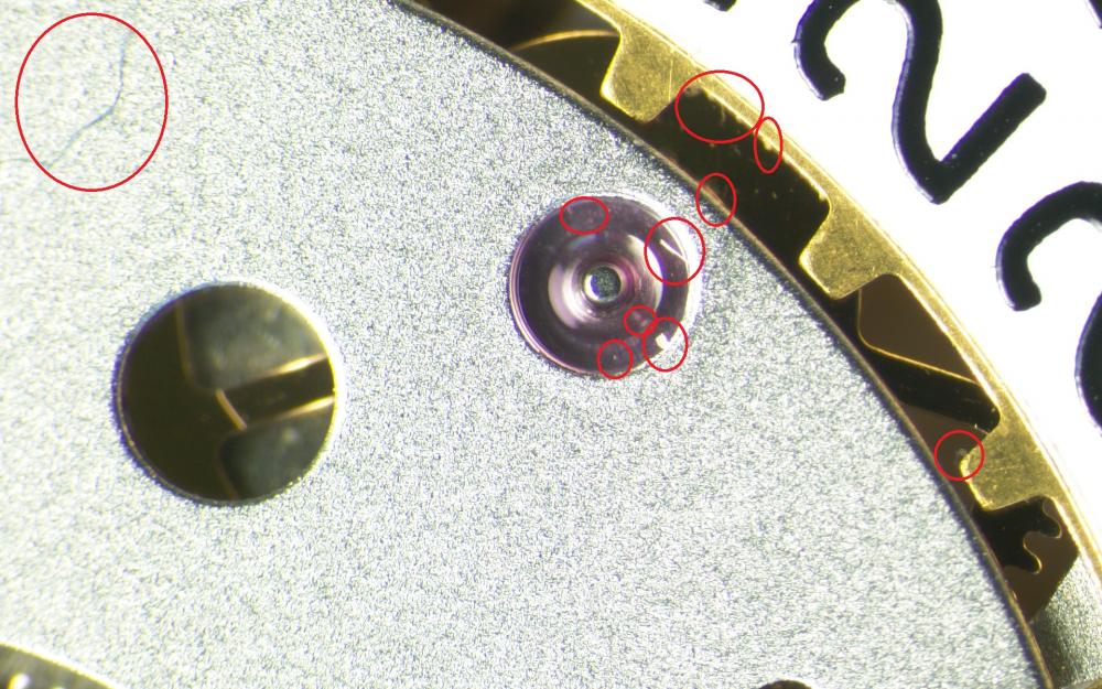

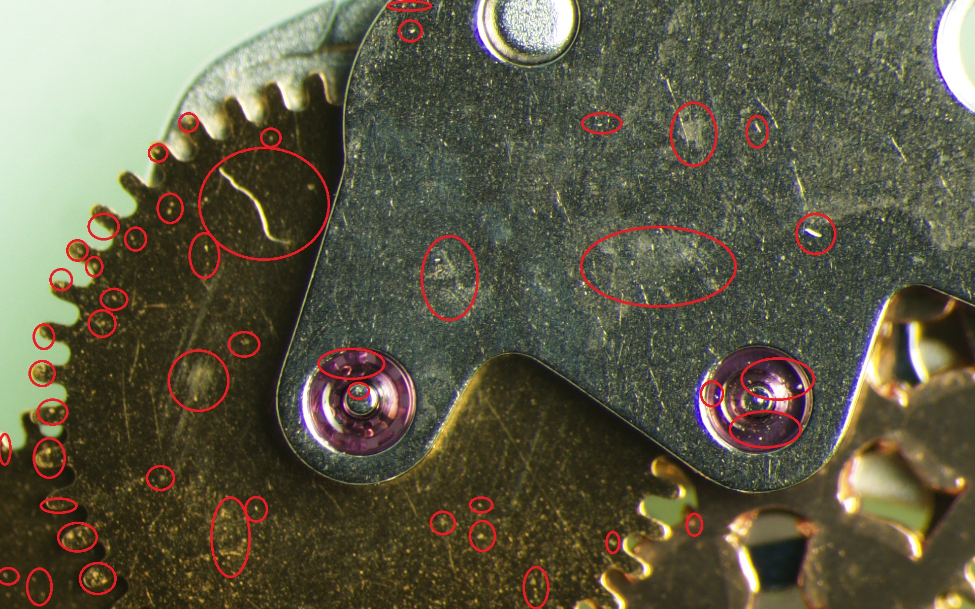

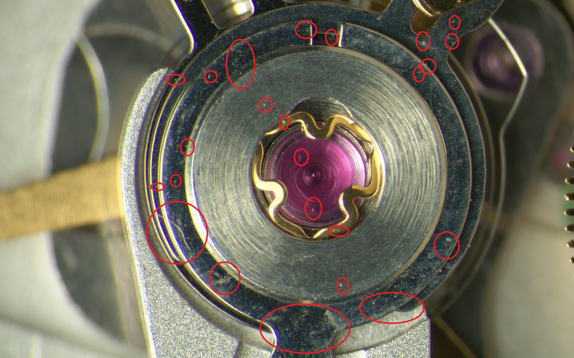

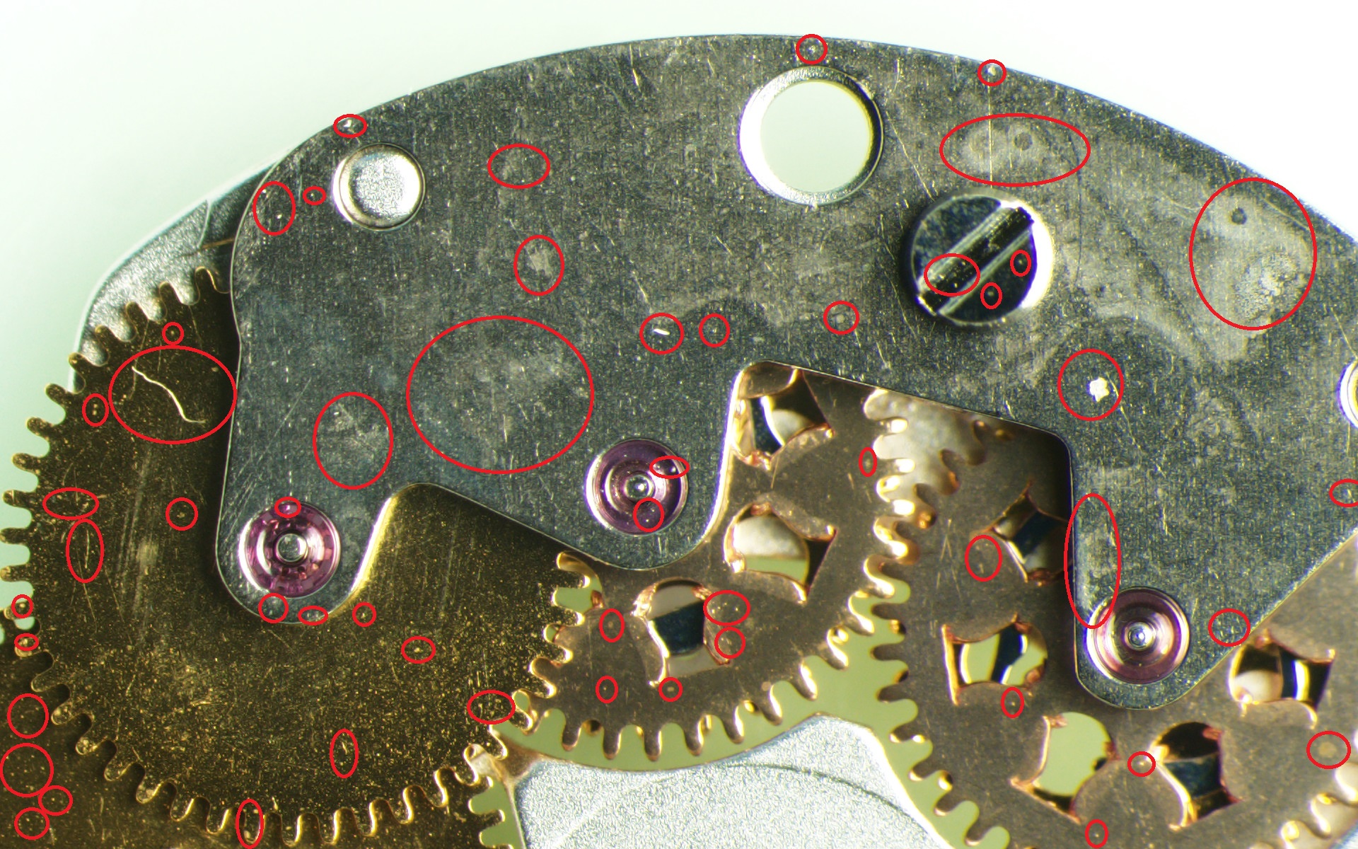

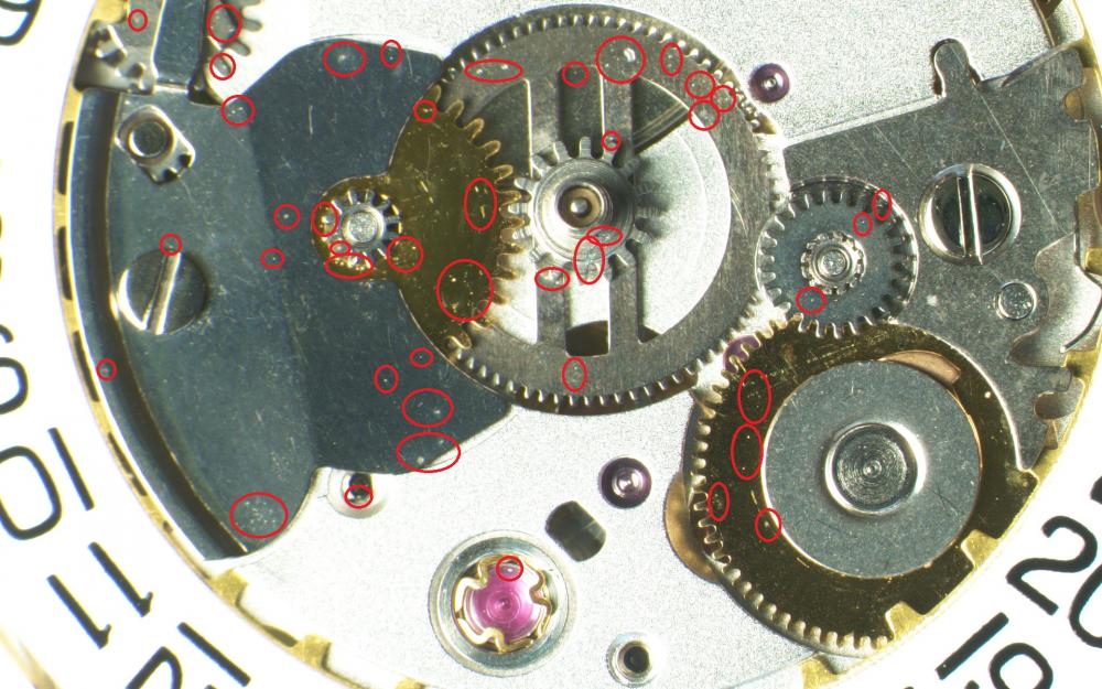

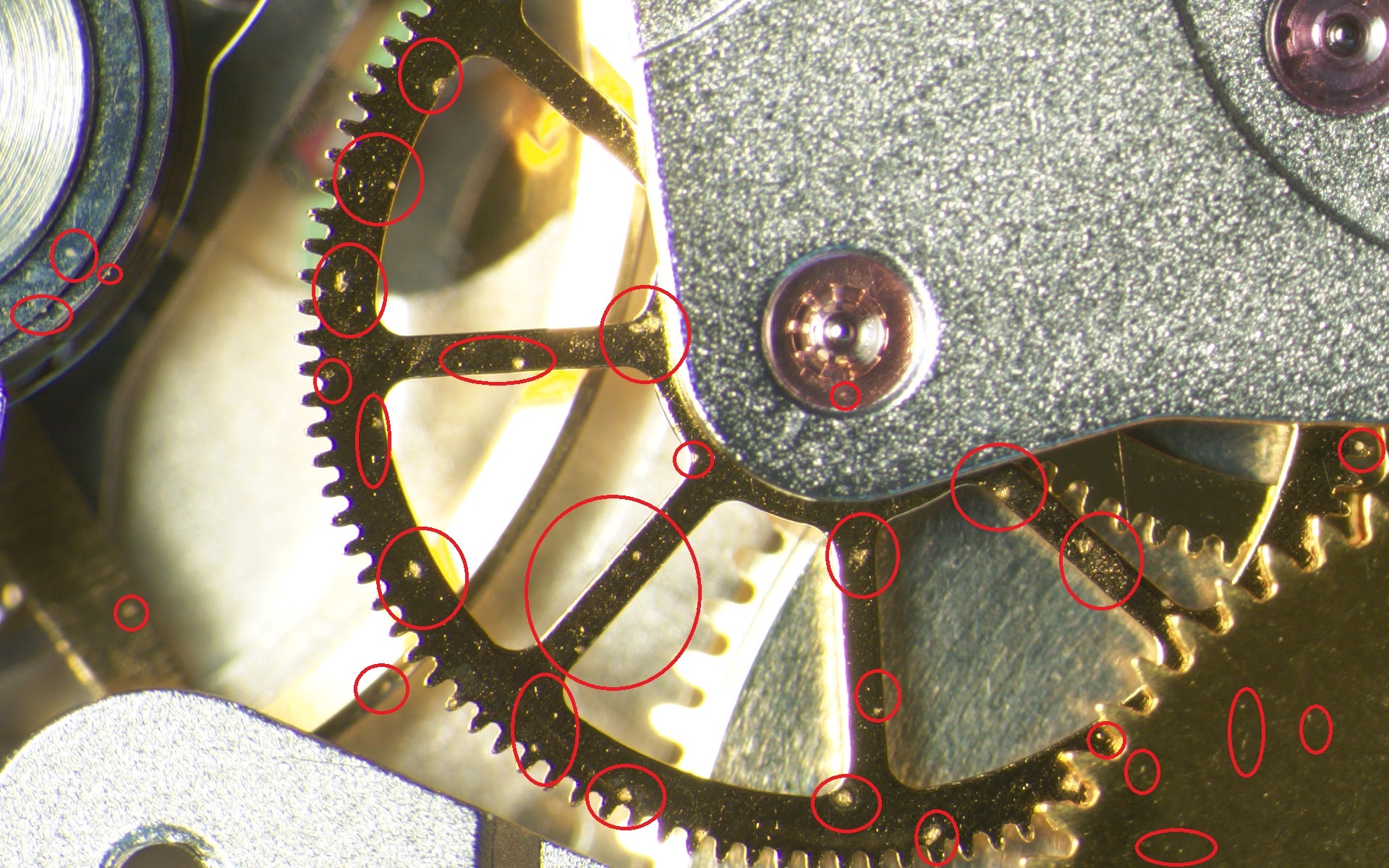

  15. I recently decided to try out one of these PT5000 movements. I had been hearing good things and had an appropriate project, so I figured "why not"? The movement arrived fairly quickly from an ebay seller and came packaged in the typical round plastic box. Initial impressions were positive: the plastic box was taped shut, and the overall appearance of the finish was very nice. However, once placed under magnification, my opinion changed. I've seen quite a few Chinese movements, but I've never seen anything so completely covered in crud in my life. I have scrap movements that are cleaner. However, I had to see how it would run, so I wound the movement and set it on the timer. In dial-up position, it actually ran well: -1 sec/day, 270 degrees amplitude, 0.1ms BE. Not half bad. So, I decided to give it a go to see how it would do over time. For about 20 hours, no problem, but then it siezed up and would run no more. Jostling and rewinding had no effect. It was done working. This brand new movement needs to be overhauled before it can be used in a watch! What at first seemed to be a great, well made alternative to the 2824-2 turned out to be a complete waste of time. Check the photos below and you'll see a well made movement covered skin cells, fibers, metallic debris, heavy finger print residue, what looks like bits of food and droplets from someone talking or sneezing all over the movement, and in the oil around the jewels. HK Precision is SO CLOSE to making a great movement, but they utterly blew it on assembly. Such a crying shame! PT5000__009 DIRT.tif PT5000__010 DIRT.tif PT5000__007a (6) DIRT.tif PT5000__007a (7) DIRT.tif PT5000__007 DIRT.tif
