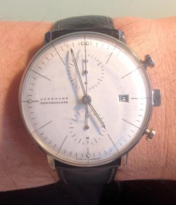

  2. Junghans Chronoscope today - this has a 7750 movement under the hood.
    1 point
