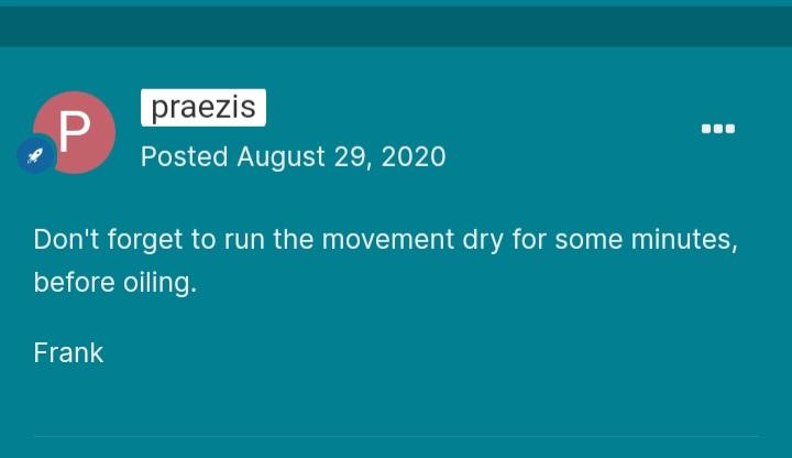

Neverenoughwatches Posted April 27, 2024 Posted April 27, 2024 10 minutes ago, VWatchie said: As far as I know, the only time an epilame treatment has potential drawbacks is when something is rubbing on the treated part w/o lubrication in between creating abrasive dust. That is, I don't believe in the method of "running the watch to make a groove through it first in the pallet stones where the lubrication is then placed". So, I think the rule would be; do not epilame treat parts where rubbing is going on without lubrication. Other than that I don't think we have anything to worry about. That said, I'm not an expert, and I'm always happy to learn more. Has any other repairer than Alex suggested or explained the "making-a-groove" method? My impression is that it's just something he constructed in his mind. I have not perceived it as a generally practiced method. Again, I could be wrong! I think I've heard that more than from just Alex. That doesn't make it right though, but I'm convinced i saw some literature diagram explaining why to do that. There must be good info here in the archives, I'll have to have a dig around. 1 hour ago, VWatchie said: As far as I know, the only time an epilame treatment has potential drawbacks is when something is rubbing on the treated part w/o lubrication in between creating abrasive dust. That is, I don't believe in the method of "running the watch to make a groove through it first in the pallet stones where the lubrication is then placed". So, I think the rule would be; do not epilame treat parts where rubbing is going on without lubrication. Other than that I don't think we have anything to worry about. That said, I'm not an expert, and I'm always happy to learn more. Has any other repairer than Alex suggested or explained the "making-a-groove" method? My impression is that it's just something he constructed in his mind. I have not perceived it as a generally practiced method. Again, I could be wrong! Ok well i went through a good half of this thread and this is probably where i originally aquired the info. 1 Quote

VWatchie Posted April 27, 2024 Posted April 27, 2024 7 hours ago, Neverenoughwatches said: I think I've heard that more than from just Alex. That doesn't make it right though Oh well, if Master @nickelsilver says it's the way to go, then it is the way to go! I stand corrected! Are there any other places where you're supposed to remove the epilame from the contact point of rubbing? I don't think so! 7 hours ago, Neverenoughwatches said: Ok well i went through a good half of this thread and this is probably where i originally aquired the info. Thanks for the effort @Neverenoughwatches, much appreciated! Quote
