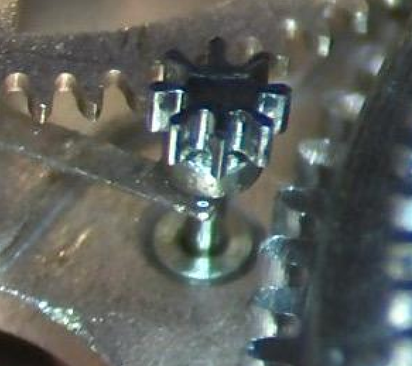

I just came across a similar problem with an Omega 1022.  The problem I had was the seconds pinion spring was bent out of shape and did not even engage with the wheel properly, so the seconds hand was not moving at all. (no power loss though :)

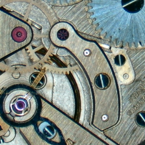

It makes you wonder who worked on the watch before you and why the spring is bent out of shape? Then there's the other strange problem of the pinion? The parts listing for this watch the image that part is not quality at all
It would be really nice to find a picture of the part in the original package but this is an image I found online

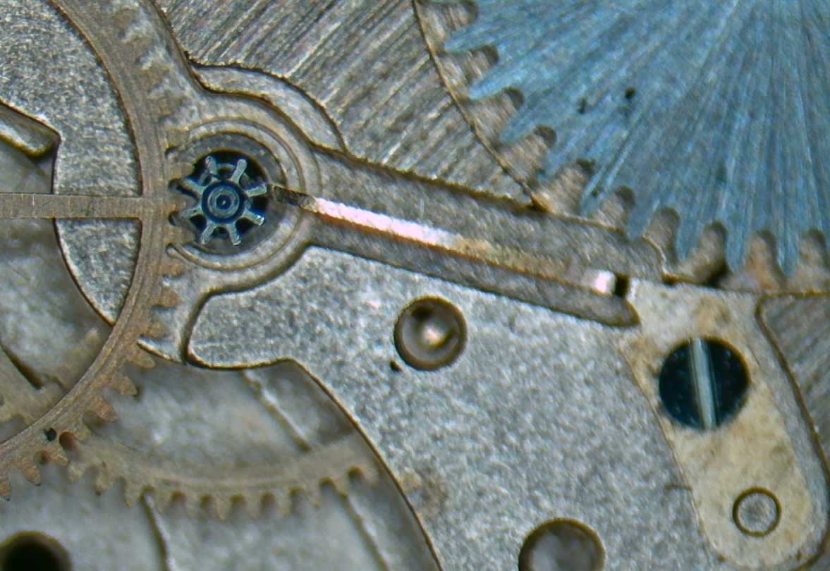

Then what was bothering me was here is an image from a 1012 and you'll notice the spring set up is entirely different? So wonderful ever modified your spring did something to the pinion also? But again it's it is working maybe it's fine

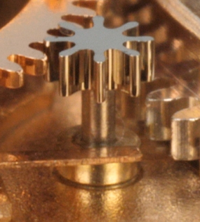

There were things bothering me about this discussion that took me a while to figure out the problem. In the image below it appears to be the spring may be pushing up? Normally when Omega has a spring pushing up the pinion has a pivot with a bridge to hold it in place so in other words the spring can push on something that stationary as opposed to this which appears to be floating?

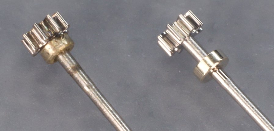

To understand the problem with the above image we need another image of side view which I have below. In my image down below on the left-hand side it agrees with the image up above. But the only problem is the left-hand side is defective and the right-hand side image is the way it's supposed to look.

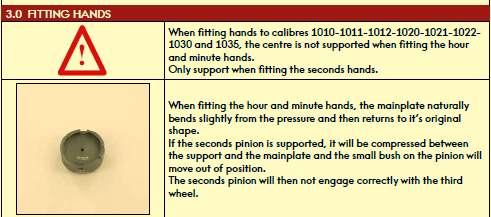

Then Omega if you can access the right documents does explain how and why this problem occurs. With the pinion floating around it might be assumed that you support it when putting on all the hands but you do not because as noted below if you do this small bush on the pinion will relocate out of position exactly what we see in the image up above.
Then Omega does not mention this but there is a possibility of also damaging the pinion and causing the bush to move to where it's not supposed to be when removing the hands.

Well spotted John. Yes your spring is incorrect @TimeWerks, it should be pushing the pinion down in to the mainplate as shown in @JohnR725's pic, not up as you show it.
